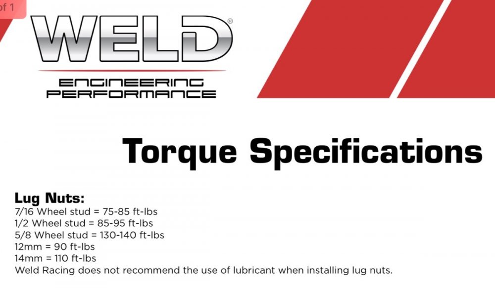

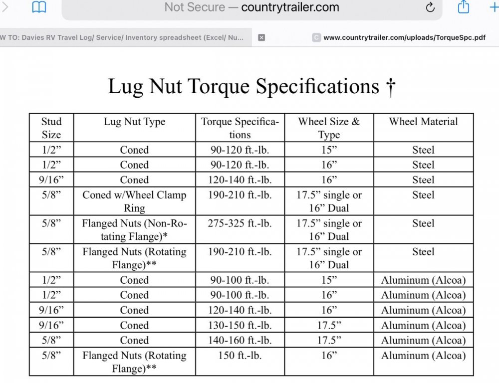

taylor.coyote Posted August 10, 2021 Share Posted August 10, 2021 Hello John, I noticed on your service list that your torque values for the lug nuts is 90 lbs this is different than the service bulletin posted by Jason / see below 120 lbs seem a lot. Please explain why you choose a lower torque value than the factory recommendation JEssary Oliver Staff 40 Posted March 10, 2017 TORQUE SPECS WHEEL LUG NUTS STAGE 1: 90 LBS STAGE 2: 110 LBS STAGE 3: 120 LBS 1 2016 Legacy Elite II, Twin Beds, Hull #124 Tow Vehicle: 2019 Ford F250 4x4 / Short Bed / Crew Cab / 6.7 Diesel Fieldbrook, Ca Link to comment Share on other sites More sharing options...
John E Davies Posted August 10, 2021 Author Share Posted August 10, 2021 1 hour ago, taylor.coyote said: 120 lbs seem a lot. Please explain why you choose a lower torque value than the factory recommendation Hi, thanks for your question! There was a thread about this a few years ago, but I can’t find it. I even started a service ticket back then asking WTF? I never got a satisfactory answer about where they got that figure. (The same ticket asked why they did not have a correct tire pressure chart.) The bottom line is that 120 ft pounds is simply too much for a 1/2” stud. Typical recommendation is 90. Some sources go as high as 110. This one says 90-100 for a 16” alloy wheel. And this one: Tire Rack, Wheel Lug Torquing OTH, 120 is perfect for a 9/16” stud. Do some research, if you can find a source that says 120 for Dexter 1/2” studs, please post a link, I would appreciate it. I have been using 90 for five seasons with no problems. After the initial installation I retorque them after say 100 miles, and they rarely need any additional torque after that. How is the download working? I haven’t been back to this thread in quite awhile. I am still using the log, it has been a great help. John Davies Spokane WA. 1 "Mouse": 2017 Legacy Elite II NARV (Not An RV) Two Beds, Hull Number 218, See my HOW TO threads: https://olivertraveltrailers.com/topic/john-e-davies-how-to-threads-and-tech-articles-links/ Tow Vehicle: 2013 Land Cruiser 200, 33" LT tires, airbags, Safari snorkel. Link to comment Share on other sites More sharing options...

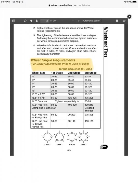

Moderators mossemi Posted August 11, 2021 Moderators Share Posted August 11, 2021 This page is from the Dexter Axle Manual. Mossey 1 Mike and Krunch Lutz, FL 2017 LEII #193 “the dog house” Link to comment Share on other sites More sharing options...
John E Davies Posted August 11, 2021 Author Share Posted August 11, 2021 10 minutes ago, mossemi said: This page is from the Dexter Axle Manual. Mossey Thanks. All well and good, I think I have seen that page before, but the specs are for steel wheels. Alloys usually have a lower recommended figure. John Davies Spokane WA 1 1 "Mouse": 2017 Legacy Elite II NARV (Not An RV) Two Beds, Hull Number 218, See my HOW TO threads: https://olivertraveltrailers.com/topic/john-e-davies-how-to-threads-and-tech-articles-links/ Tow Vehicle: 2013 Land Cruiser 200, 33" LT tires, airbags, Safari snorkel. Link to comment Share on other sites More sharing options...
