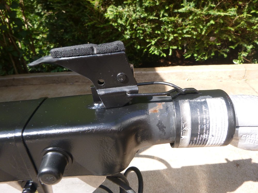

Three years ago (shortly after I took delivery of Twist) I found that I could not see the hitch on the Oliver very well when using the on-board camera in the truck.  Buzzy (another Forum member) had the same problem and we both came up with a similar solution at about the same time.  We painted the hitch florescent orange.  Certainly this made it visible, but, that paint fades in a very short period of time.  I tried repainting again and top coating with clear sealer, but, the end result was the same.  Last year I again repainted the hitch but used "hammered" silver.  This has worked much better, keeps the hitch looking new and is easily seen from the truck.  While at it I also lightly sanded the areas on the rest of the hitch assembly that had rusted and gave then a couple of quick coats of Krylon Black Satin.  This matches the original fairly closely.

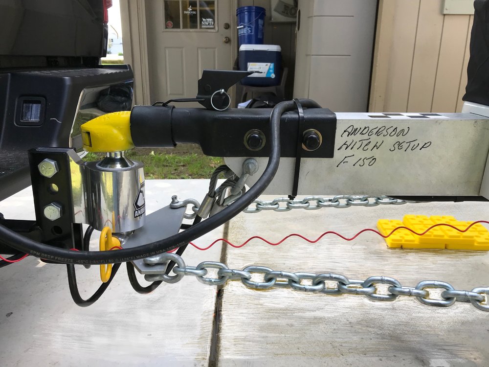

Finally, note in the one picture the small strip of closed cell foam that I glued to the top of the release handle on the hitch.  This prevents the tailgate on my Ford F-150 from hitting that handle and scratching/denting either one.

The Krylon dries quickly (less than an hour) while the Rust-Oleum takes overnight to really dry.

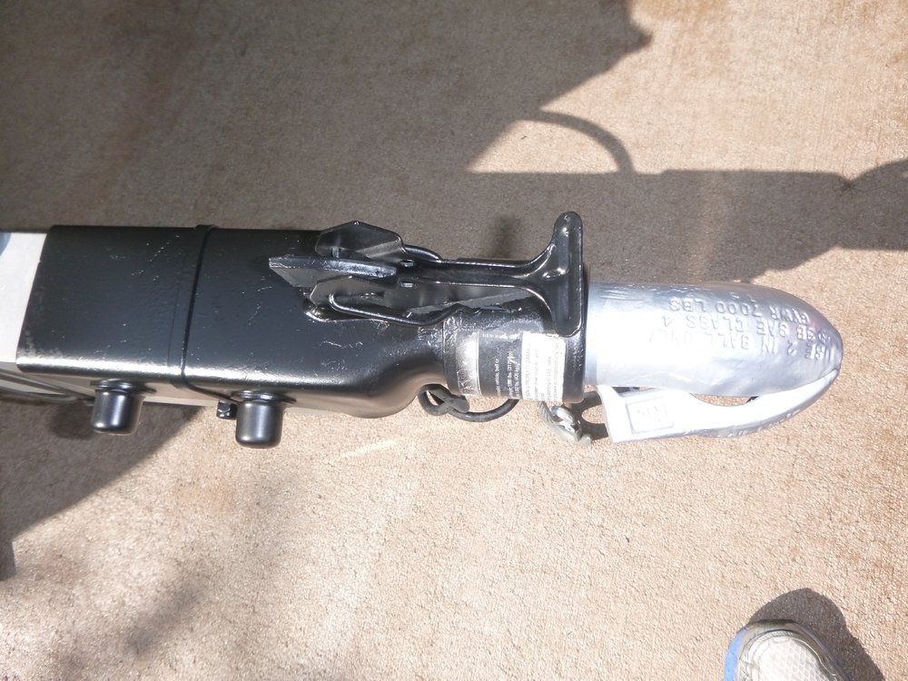

Both Buzzy and I started out with florescent orange but found that any of these "florescent" colors tended to fad fairly rapidly.  I have finally settled on a simple silver - the contrast to the black and light color of the silver gives the visibility that I need plus it dries really fast when applied, does not build up to thick layers as fast as most other paints and while easy to be seen it doesn't scream at me or detract from the other nearby components (i.e. Andersen whale tail and chains).
During my storage preparation process I sand the area where that slip collar slides back and forth and give it a shot of new paint for the winter.  Come Spring everything is ready to go except for a shot of silicone on both the collar and the area of the bulldog that slides under the collar.
We have been using a silver paint on the bulldog coupler since we returned from the factory pickup in 2015.  It has worked great, this fall I did repaint the coupler, but the paint has lasted very well.  I have tried using florescent colors for outside use on other things and it does fade fairly quickly.  The silver shows up in the rear view camera and it makes hookup easy.
