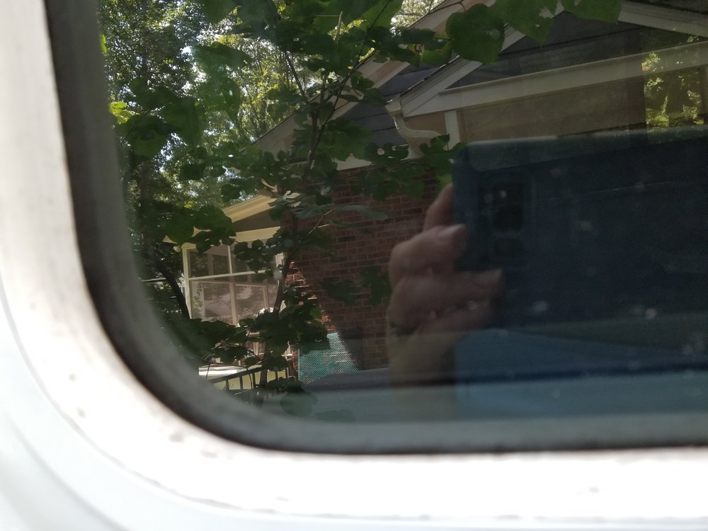

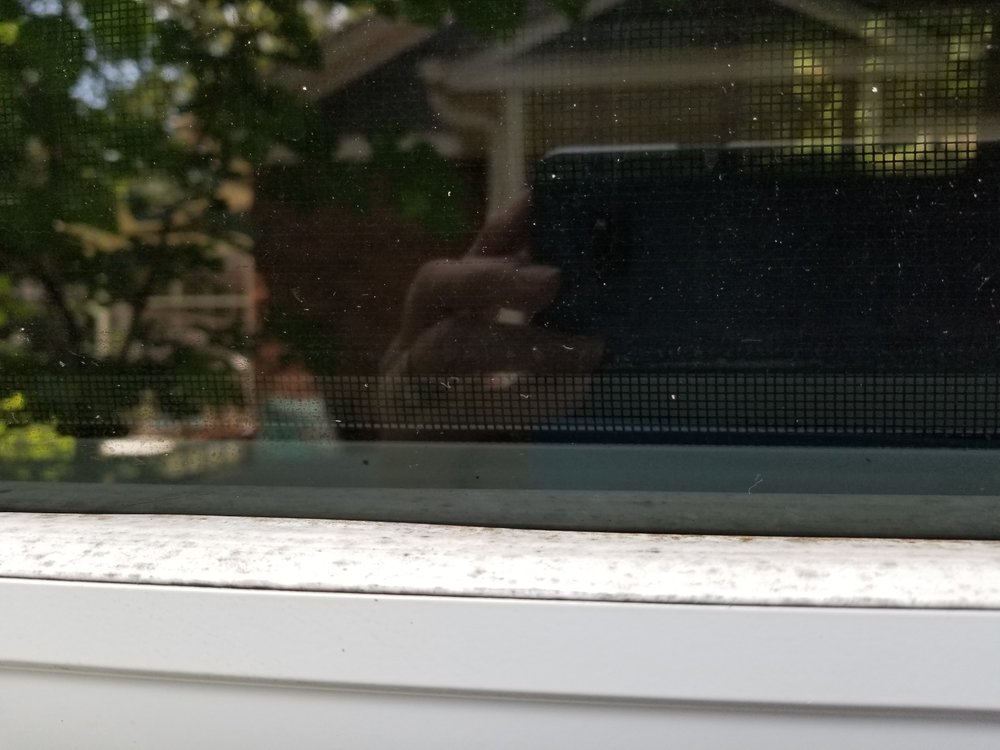

What should I use to clean the 'band' around the exterior windows? See pic for my definition of 'band'. Kinda hard to see the 'band' due to reflections in window.Hopefully, you'll understand. If not, let me know.

Pics did not upload as I expected on my first go around. These pics are related to my post re cleaning exterior windows.

Just the other day I was cleaning some tree sap off the fiberglass with plain old mineral spirits.  I tried some on a small spot of white caulk that was used to seal my windows and it worked wonderfully well with very little rubbing.  I had previously used Acetone but I was always afraid that this was simply too aggressive.  It looks to me from your pictures that you have a bit of mildew, so, I'm not sure if the mineral spirits will work.  But it is worth a try.  Good luck!

Re the 3M product ---- do you have any idea if it would work on mildew? I should have stated this in my original post & topgun rightfully pointed this out. We live NC where it is quite humid. I looked at the 3M product page & it did not say anything about mildew. I did read that I can use white vinegar & water. This is my standard household cleaner & I did use it to remove the bulk of the mildew. I would really like to make the 'band' shiny white again, if that's possible. :)

Thank you, topgun/Bill, for your response. I will try mineral spirits & see what happens. And, yes, you are correct -- it is mildew on this plasticy/vinyl strip. As I mentioned to John Davies, we live in NC where it is quite humid & we currently keep our camper outside & in the open. Someday we will have an inside space for it but I doubt if it will have have heating & air.
