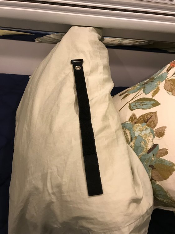

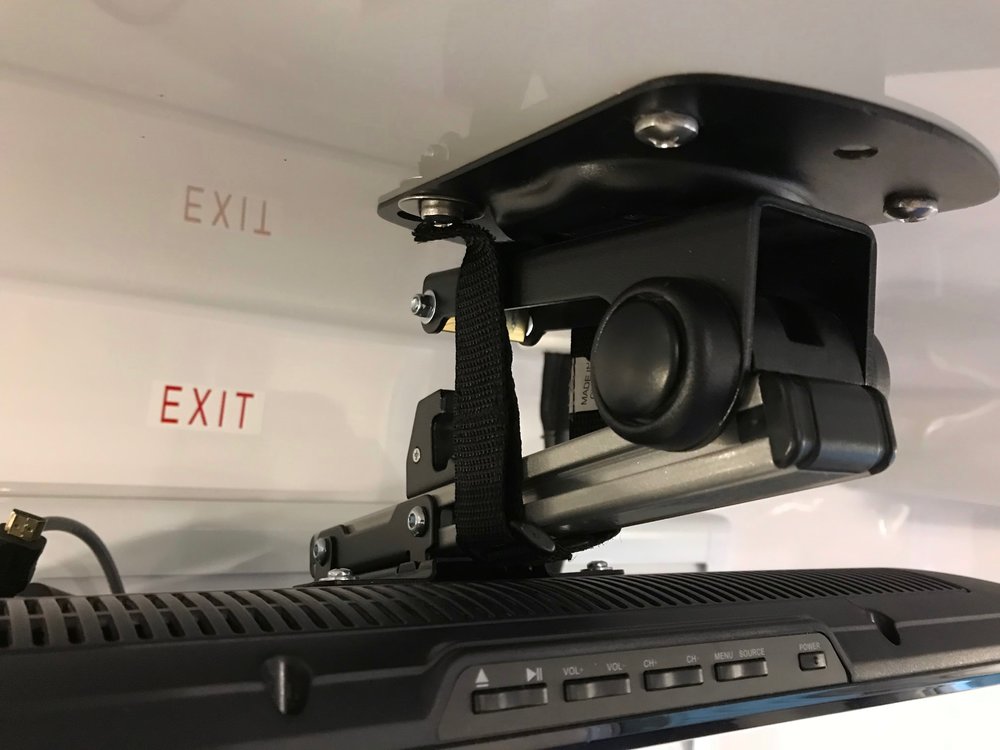

I could not agree more with John Davies,  who came up with this? We were driving home and the mount on the bracket decided to deploy on it own'', You could hear the TV crash in the downward Position. Hell we were doing 60MPH and you could hear it in the Truck! This is my fix a velcro strap........The best i could come up with.
If you tighten the hex screws on both sides of the mount it will significantly decrease the potential to come unhooked while on bumpy roads. I keep mine tight enough that the TV will stay stationary halfway down. Mike
  • Thanks 4
That gold looking latch pivots around and still deploys the TV when it wants too. I will try tightening the hex nuts '' thanks . will still backup with velcro strap.

Check all the screws and adjust tightness if needed. Also, make sure the rotating cam/pawl lock is turning freely.

We had a corner mount TV. I wanted to move it to the center and used the mount Steve recommended. We like the center mount much better. There are two hex screws on the sides of the hinge. If they are kept tight it prevents the TV from moving around. We did have it come unhooked once after a rather large bump. Lots of other things moved around too. Once in well over 20K miles is acceptable... Mike

So how is this thing suppose to work'' ? Push up and it locks? pull down and it releases? Maybe I have a bad one '' it deploys when it wants too. Is it a one hand operation?.................Please advise............Yukon
The way it should work: push the TV up until it engages the latch. To let it down, push up on the TV and the latch should release and the TV can swing down. If the hinge is too loose then the TV could bounce around on rough roads and release itself. Maybe your latch isn’t positioned correctly? Mike
It's a 2 handed operation. With one hand hold the gold latch vertical, then push up on the TV to where the latch is able to set in the hook on the mount.
