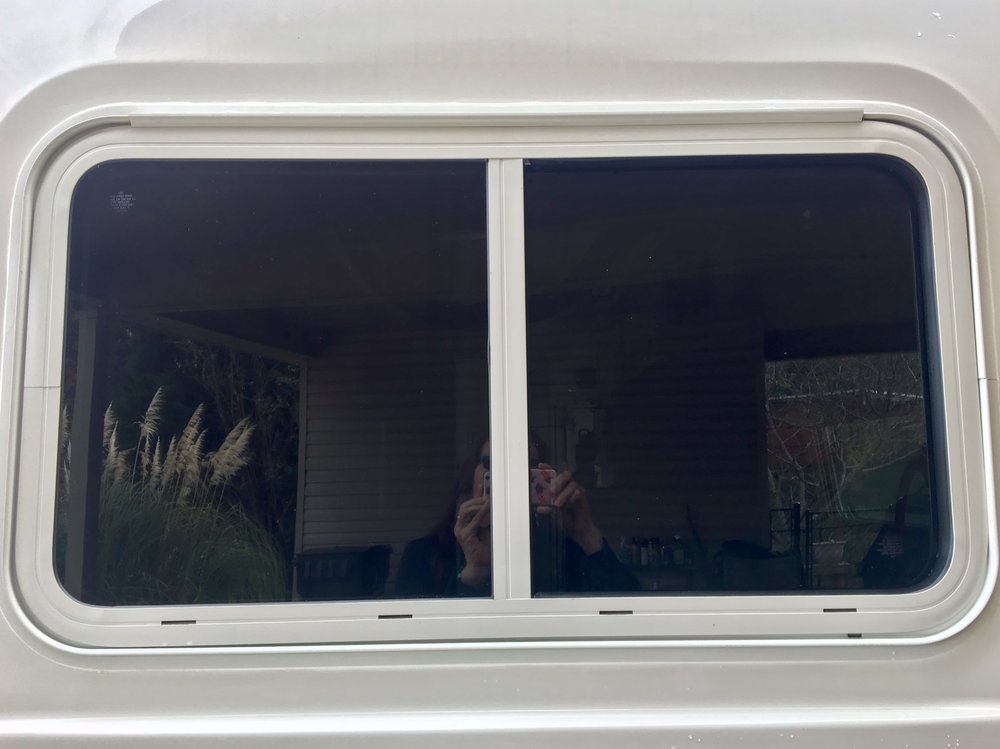

geO Posted November 18, 2018 Share Posted November 18, 2018 A little update on our back window. We tried to work on it some more this morning to no avail. You can notice from the picture that the window itself it's not leveled. The right side is higher than the left side and you can also see the weeping hole at the bottom right. When we were at the plant we told them exactly where the leak was. They had one job. We noticed the window not square, why didn't they??? The only thing left for us to do now is put plastic and duct tape around the window, since rain is in the forecast, order a new window, pay for the shipping and pay for someone else to install it. We are very disappointed. What hurts us the most, however, is the fact that they disappointed us many times now and NOT ONCE they have tried to somehow make it up to us. Link to comment Share on other sites More sharing options...

Overland Posted November 23, 2018 Share Posted November 23, 2018 The window is obviously skewed. So I’d think that as long as it hasn’t been damaged from use, it should be replaced by Oliver at the window manufacturer’s expense. I’d ask them to do it for aesthetic or functional reasons, regardless of the leak, though you’re probably correct about that being the cause. Like Bill suggested, I’d send an email to Scott with that photo and an explanation of your problems having to go back multiple times to get things fixed I’m certain that they’ll take care of it. 1 Link to comment Share on other sites More sharing options...

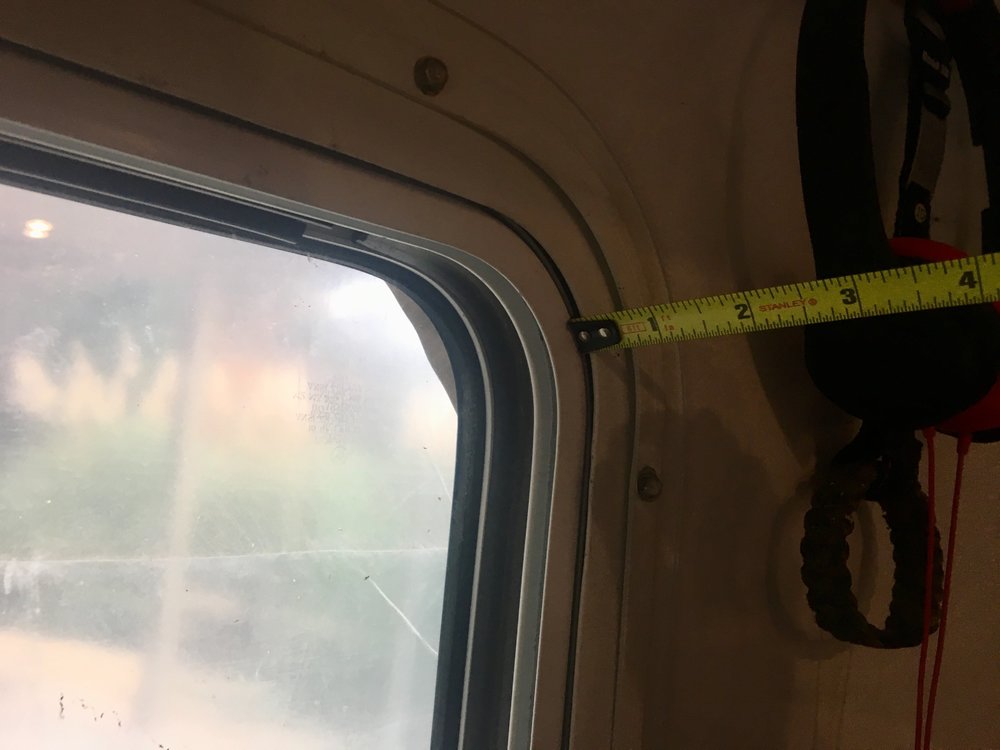

geO Posted November 23, 2018 Author Share Posted November 23, 2018 a closer look of the inside. Link to comment Share on other sites More sharing options...
Overland Posted November 23, 2018 Share Posted November 23, 2018 Are you sure it’s latched on both sides? Link to comment Share on other sites More sharing options...
geO Posted November 23, 2018 Author Share Posted November 23, 2018 Are you sure it’s latched on both sides? Yes, it is locked on both sides. Link to comment Share on other sites More sharing options...
DavePhelps Posted November 23, 2018 Share Posted November 23, 2018 Man those reveals are pretty bad. When I get home I'll check my window and get back to you. That shouldn't have left the factory like that. 2015 Oliver Elite, Hull 107 1998 Ford E-250, 5.4 liter Link to comment Share on other sites More sharing options...

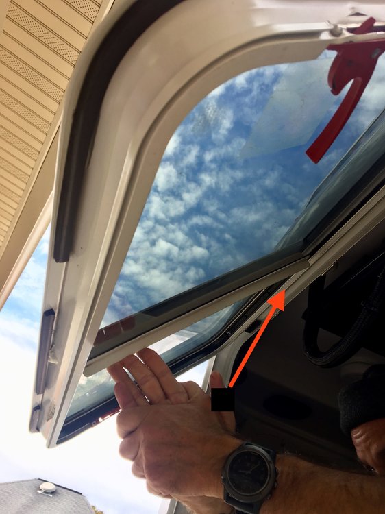

geO Posted November 23, 2018 Author Share Posted November 23, 2018 EXACTLY! I would have never known how bad it truly is unless I took off the window blind. Now it reveals the underlying issue. This breaks my heart especially having been at the plant telling them of this leak. Link to comment Share on other sites More sharing options...
bhncb Posted November 24, 2018 Share Posted November 24, 2018 This topic peaked my interest so I just looked closely at the rear window on my summer 2018 build. If I took a picture, it would look exactly like the one in George's original post. It's pretty obvious that the frame is out of square because the hinged escape insert makes no contact with the bottom plastic guide on the curb side but must be forced onto the street side guide. Likewise, my insert is slightly off-center to the street side. I haven't noticed any leak but further investigation of the whole assembly is pending... Link to comment Share on other sites More sharing options...
