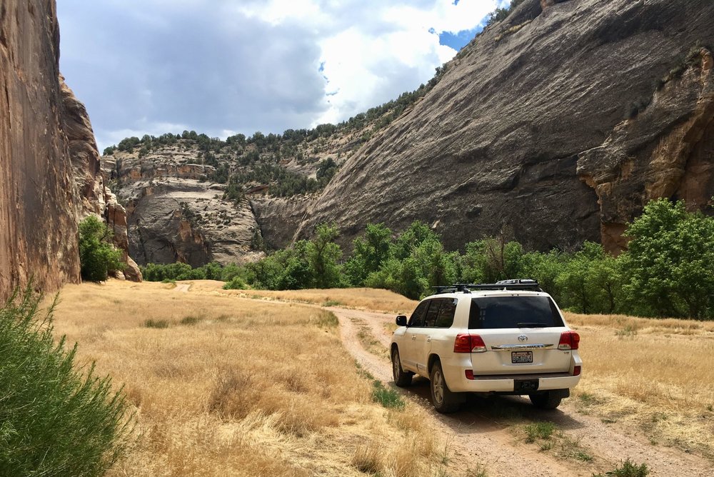

Is this what you have in mind?
https://www.nps.gov/dino/planyourvisit/echo-park.htm
Many of these primitive tracks are impassible when wet, use caution, wait for roads to dry out after a summer thunderstorm, which they do quickly. Bring basic recovery gear. A pair of Max Trax boards will make you feel a LOT better about venturing off pavement and they pretty much eliminate the need for serious equipment like a winch, if you are careful and don’t take chances...
