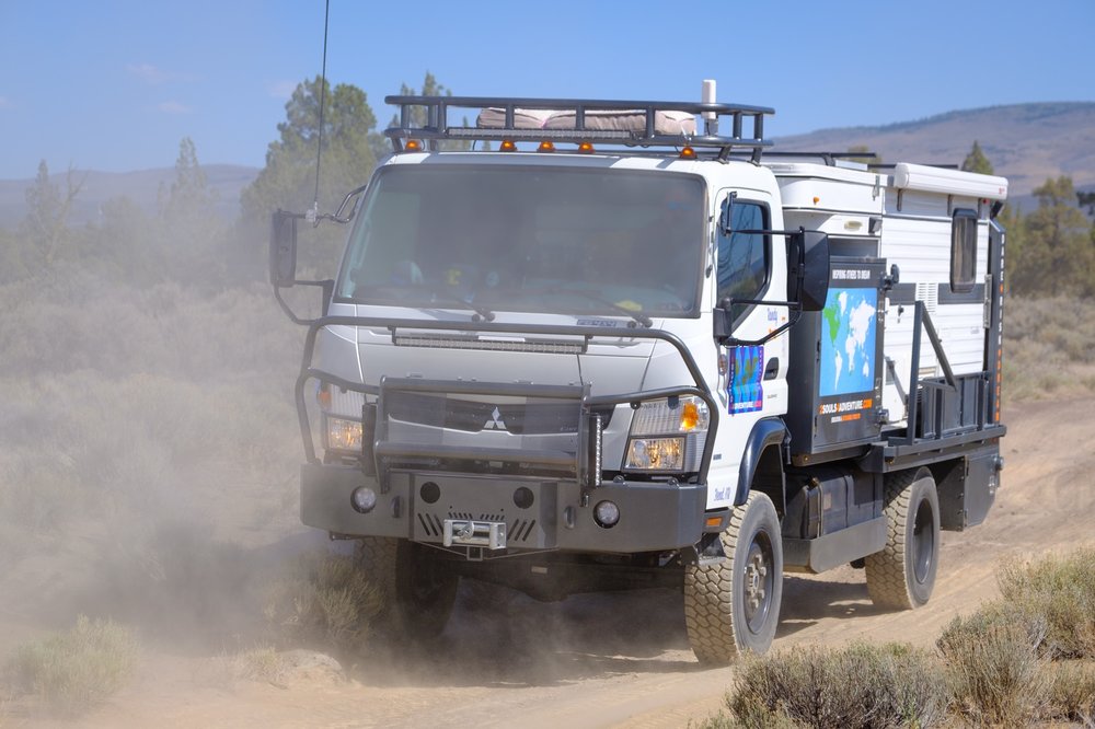

John E Davies Posted January 27, 2019 Share Posted January 27, 2019 Cptdondo, do you regularly boondock? If not a medium sized pusher diesel motorhome with a good offroad toad like a Wrangler Unlimited with roof rack checks most of your buttons. Being able to drive to trailheads really complicates your decision, since even a shortbed HD truck with no camper is a real PITA on those vertical ledgey secondary forest roads and high passes.... every reply you make adds more info that makes things harder. Can you post pics or a link to your custom Roadtrek? I’m assuming you already have the lifted 4wd chassis, is the rig just too low and vulnerable for uneven roads? Do you already have bigger tires and skidplates? Have you considered posting your questons over at Expedition Portal? That sounds like an appropriate forum for your lifestyle. You could go bigger than a dinky 1 ton pickup..... Thanks. John Davies Spokane WA 1 SOLD 07/23 "Mouse": 2017 Legacy Elite II Two Beds, Hull Number 218, See my HOW TO threads: Tow Vehicle: 2013 Land Cruiser 200, 32” LT tires, airbags, Safari snorkel, Maggiolina Grand Tour 360 Carbon RTT. Link to comment Share on other sites More sharing options...

John E Davies Posted January 27, 2019 Share Posted January 27, 2019 I don’t know anything at all about the Base Camp but 200 lbs of dogs will also be a problem in an Ollie. We have two 40 lb labradoodles and it gets troublesome. Did you ever investigate converting your Sprinter to 4wd? With a 4.5” lift, transfer case, AT tires, armor and optionally regearing the axles it ought to get you around pretty well. Cost for the basics starts at $23k and goes (way) up.... it seems a shame to have a custom RV that you can’t use; a 4wd converted truck like that would have a much high resale value than a 2wd model, especially out West. You could always add a single axle cargo trailer for extra stuff, but that won’t do anything about floor space unless you are already carrying bikes inside the Roadtrek... https://whitefeather4x4conversions.com/f-a-q/ John Davies Spokane WA SOLD 07/23 "Mouse": 2017 Legacy Elite II Two Beds, Hull Number 218, See my HOW TO threads: Tow Vehicle: 2013 Land Cruiser 200, 32” LT tires, airbags, Safari snorkel, Maggiolina Grand Tour 360 Carbon RTT. Link to comment Share on other sites More sharing options...
