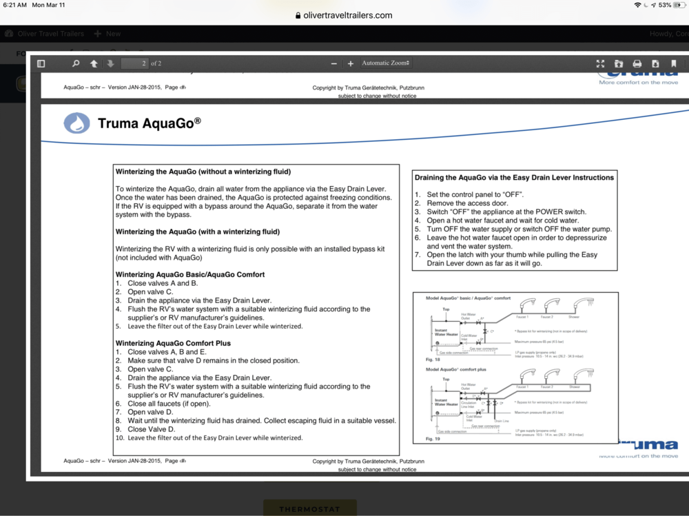

Overland, you are right. The “manual” on the University page Only has 4 and 9 steps in winterizing the Truma water heater.  But there is another separate instruction on the University website that is called “ winterizing the truma water heater “. That version has the added step that says to not put the filter back in. see pictures
I can’t post the screen shots but if you o to the Oliver University page you can what I’m talking about. It looks as somebody added the last step in the “winterizing “ version but it’s not in the “oficial “ manual. Since I was not given physical manuals when I got my Oliver because I was told they where all online, now I have an issue which is : which manual is the right one.....
What’s telling, apart from the different font, is that flyer is dated 2015. My manual and the one on Ollie U are both dated 2016, so you have to assume that those supersede that flyer. At some point someone thought that instruction needed to be added but the info either never made the rounds at Truma or they decided in the end not to add it
It’s a weird situation.  Some clarification from Truma is needed.  Regardless, I don’t know what real chance you have but at least you have a good argument to get the unit replaced under warranty.
All that aside, it’s not a big deal to leave the filter out so regardless of the manual discrepancy that’s what we should all do just to be safe.  I hate that you’ve run into this issue but I’m glad that you’ve made us all aware.

[attachment file=Truma Instructions.png]

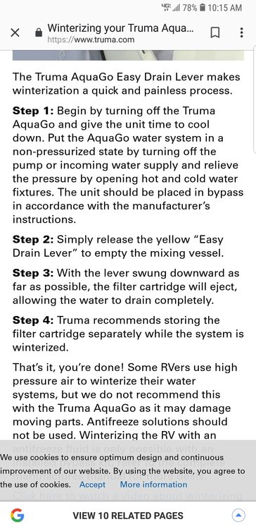

I don’t know where that Truma document on Oliver University came from. When I google the title of the document (AG_Maintenance_and_Winterization Truma) or the first sentence of the document, my only hit is at Oliver University. When I go to the Truma US website and search for Winterization, I only find this page, which states "Step 4: Truma recommends storing the filter cartridge separately while the system is winterized."
[attachment file=Truma Web site.png]
Notice the language? Recommends. Not You Must.

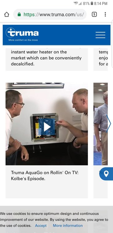

I don't have a dog in the hunt, as our water heater is a Girard, but I also found the info David S. found, plus the (also) 11/18 winterizing video from Truma.
What I do remember from a few years ago, when we were looking for an instantaneous water heater, was the Truma claim of simple winterization. Pull the lever... and done.
I poked around today, as I feel really bad for Corcomi. I found two videos on the Truma site, still talking about just draining... nothing about removing filter.
The kolbe segment. Start watching at 10:30
And. The zagami segment
I also found this, still on the website:
And this
I woke up in the middle of the night and went to YouTube to see if there were any videos on winterizing the Truma hot water heater and as SeaDawg mentions in his comments I found the Truma video wand it doesn’t mention anything about removing and storing the filter during winterizing. It just states to clean the wire mesh and check the o rings. So I went back to the fricking manual on the University website to now read about the warranty. Well it states that the unit is guaranteed for one year, BUT if in a two month period from purchase if you register the unit you get an extra one year.  So guess what? I didn’t register it because I remember that when I took delivery on the Ollie in Nov of 2018 , I had asked where were my manuals on the different components. And I was told that they didn’t provide them because they were all posted online. Then I asked , well how do I fill out the warranty cards and I was told that Oliver would take care of all warranty work that was under warranty, so there was no need to register. So yes I would have guessed that if my water heater brok in the 6th month of taking delivery Oliver would be able to tell Truma the date of delivery to calculate the 12 month period, but what about the extended warranty????/?/?/?/.
