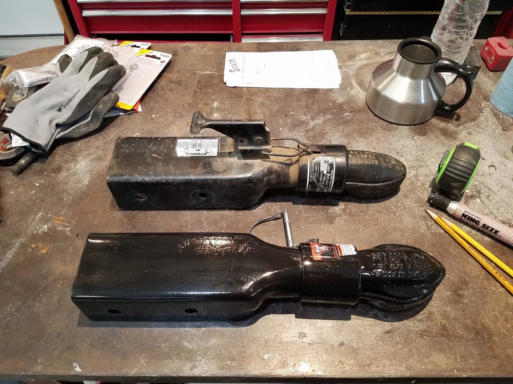

Moderator+ ScubaRx Posted April 2, 2019 Moderator+ Posted April 2, 2019 If any one has pictures of the upgraded 2 5/16 coupler I would appreciate it ... Here are a few pics of our 2-5/16” coupler. It basically appears just like the 2” one. 2 Steve, Tali and our dog Rocky plus our beloved dogs Storm, Lucy, Maggie and Reacher (all waiting at the Rainbow Bridge) 2008 Legacy Elite I - Outlaw Oliver, Hull #026 | 2014 Legacy Elite II - Outlaw Oliver, Hull #050 | 2022 Silverado High Country 3500HD SRW Diesel 4x4

Landrover Posted April 3, 2019 Posted April 3, 2019 Thanks for the pictures. Doesn’t look like a difficult change over. I have never used this type of hitch I’ll wait and put the 2in into use before I consider the change. Takeing apart the trailer and I haven’t even gotten it yet. Love it. 6/26/19 ? Grant 2022 GMC Denali 2500 HD 2019 Elite 11😎
