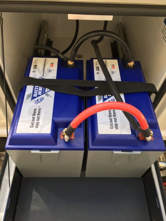

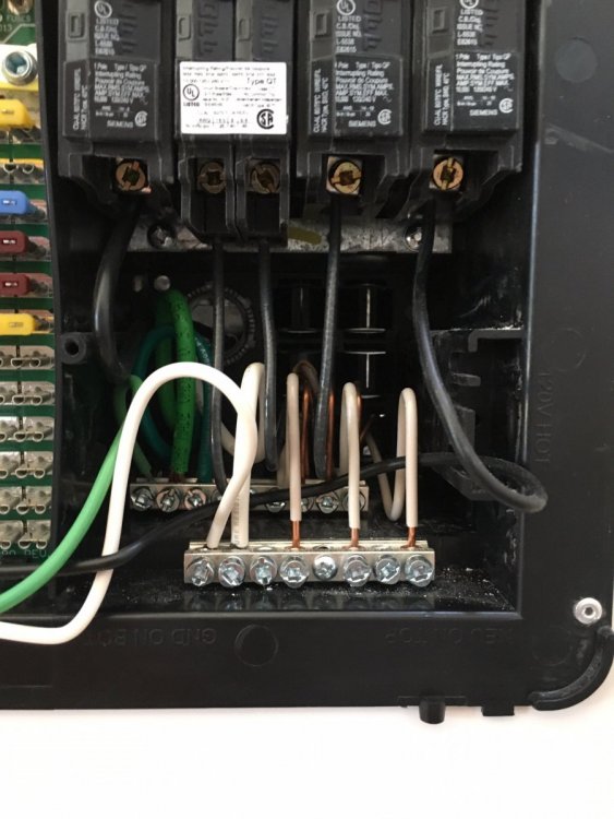

Janis, I have installed two 100Ah Battle Born batteries, changed out the Progressive Dynamics converter/charger with the PD4060LI and installed a Victron BMV-712 battery monitor.   The batteries and converter/charger change out are very easy.  The converter/changer involves one screw and five wires.
Battle Born recommended the change out of the converter/charger to get the most out of the batteries.  The charging parameters for LiFePO4 batteries is very different from Lead Acid and AGM batteries.
I have helped a few Oliver owners and installers do the same.
I would be happy to walk you through it.
If you would like to discuss further, please message me.
Andrew

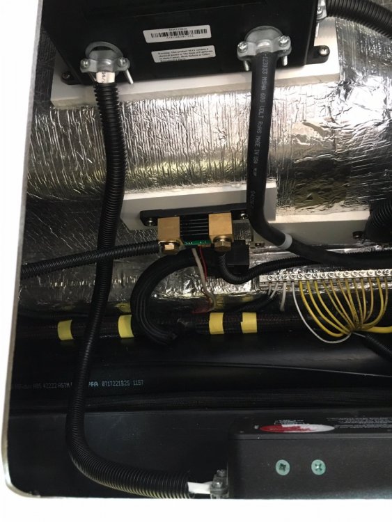

Janis, the converter/charger is on the left side of the power panel and is removed by removing the power panel cover, one screw and five wires.  The install of the new converter/charger is just the opposite.
As for the battery monitor.  My installation required two crimp on wire lugs, a small piece of PVC foam board and some epoxy glue.  The only drilling into the fiberglass was the hole for the monitor.  The Victron battery monitor can be connected to a cell phone via Bluetooth and the Victron Connect app.  If you prefer to monitor your batteries from the app, the monitor can be installed out of sight and not require any hole to be drilled.

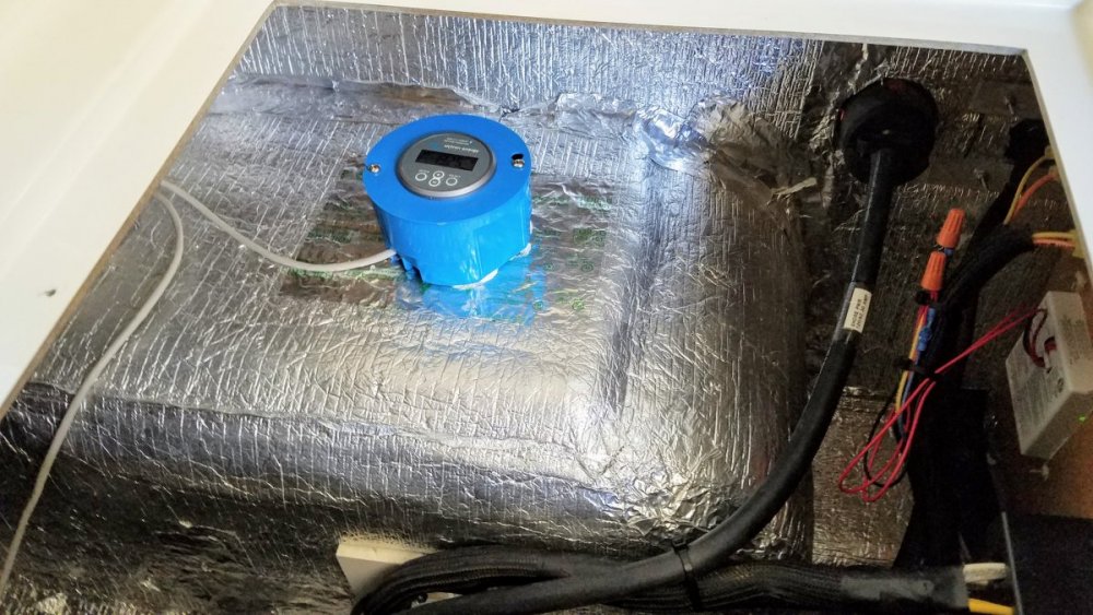

This is my Victron 712 install under the dinette seat and I use the Victron Connect app.
Mossemi, excellent, thank you for the picture.

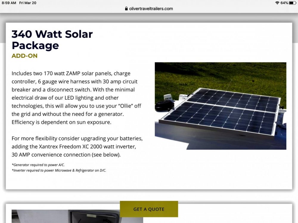

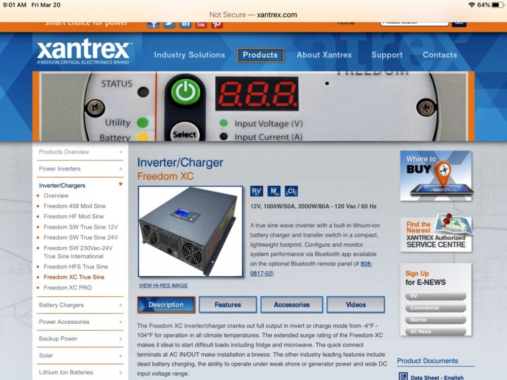

According to the OTT website, the 2020 inverter is a Xantrex Freedom XC 2000 which is Lithium friendly.
03BAAFC9-B86B-4B45-889B-07CB3D9CC1A1.thumb.jpeg.bffe000d7fac54ceccd01c13ffa230ed.jpegAC774C07-0251-415D-8405-8FBE68E75B9B.thumb.jpeg.594272d9ebfcf7f54ac3f6b5b0f1212a.jpeg
Definitely place the monitor inside the hull like Mike did - you'll use the buttons once while setting it up and again...never?  Maybe if you swap out or add batteries someday.  Speaking as someone who has zero problems cutting a hole in his Ollie, I regret having cut a completely unnecessary one for the BMV.  Save the hole cutting for adding a Victron Color Control someday, since it actually has a useful display.

The new Oliver inverter option is also a lithium charger.  It is also a transfer switch.

But going back to Janis's lithium questions, it looks like she is getting a 2020 Ollie with the new Xantrex inverter/charger/ transfer switch that supports lithium charging according to the specs I read and that agrees with the information she got from Oliver.  So she would not need to upgrade the PD equipment if the Xantrex equipment was installed to its full capabilities.  But it does seem that she may have 2 charging modules with 1 in the Xantrex and another in the PD Inteli-Power Mighty Mini.
Update on my Victron BMV-712 installation.  The picture is of my temporary install from last spring and it has worked well enough that it will stay there until I need that space for something else.
