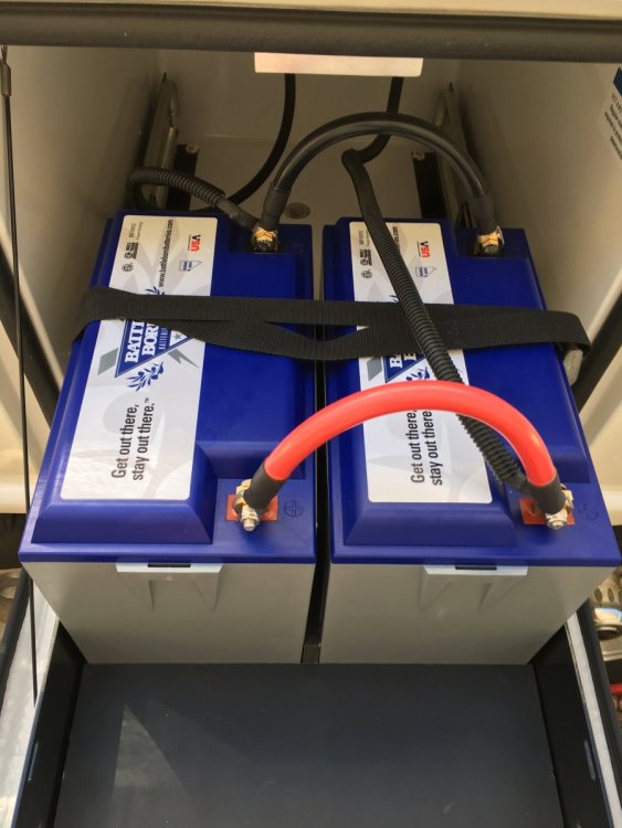

AndrewK Posted January 5, 2020 Share Posted January 5, 2020 I have installed two 100 amp hour Battle Born batteries in our Elite II. The battery tray will handle three of the standard batteries and four of the vertical batteries. The install of the batteries is simple and only requires a pair of cables to connect the batteries together. The Zamp solar controller can be changed to Lithium for the appropriate charge profile. You will need to change out your converter/charger to the Progressive Dynamics LiFePO4 model to provide the correct charging profile, when charging with AC. This is another simple direct replacement installation, with one screw and 5 wires. The only other thing you will need is a battery monitor that measures amps used, as volts is not a appropriate measure of the state of charge for LiFePO4 batteries. We could not be happier with the addition. If anyone is interested in any additional information or pictures, please Private Message me with you contact information. Andrew 2 Andrew 2019 Legacy Elite II 2018 BMW x5 35d Link to comment Share on other sites More sharing options...
