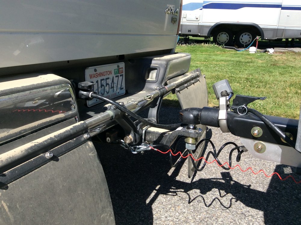

I really wanted to pull our new Elite II without the Anderson, but since my toe vehicle described below is right on the borderline of needing one or not, I have decided to go with one. Too many on this forum said get it, so I got it.
trainman
trainman
I’ve got the same truck, same specs and use the Andersen. No issues. Mike
I agree with Mike on the Andersen.  However, late last year I was having increasing difficulty in getting the pin holding the "whale-tail" both in and out.  Not being the brightest bulb, it took me way longer than it should have to figure out that all I needed was a very small amount of lube on that pin.  Now everything is back to normal.
I got my Anderson yesterday and will be taking it with us when we pickup the trailer. Not knowing if Oliver will install it as it was not purchased from them, I will take what tools I need with me to do the install myself if they won't. Today I purchase the extra chain I will need and quick links for the install, plus I did purchase a different pin, the type with a handle to make it easier to remove from the "whale-tail" as some call it. As far as some have mentioned about backing up, my biggest concern is that I can keep the "whale-tail" in the correct possession when I'm ready to unhook, I think I will unhook when the "whale-tail" is inline and them back up where I want to park the trailer. I think this is just another step I would rather not do, but I don't see and easier way to do it, is there other ways to end up with the "whale-tail" in the correct possession and alignment I would like to hear for you, thanks.
trainman

I have found that it rarely is a "problem".  However, via experience, when in situations where I think that getting back to the same angle/alignment that I had when I unhooked, I'll simply take a couple of rocks or sticks and place one by each of my driver's side tires.  This way I have something concrete (versus my memory) to guide me back into the "correct" vehicle position when I'm ready to hook back up.
Trainman:
Since you have the newer Anderson WDH there is no issue when reconnecting your tow vehicle to the trailer.  For any reason that you can not reconnect the  “whale-tail”, just raise the trailer ball coupler so it is not touching the trailer ball.  Then insert the pin that holds the  “whale-tail” in position, then you can turn the trailer ball so the  “whale-tail” can be connected.  I could not do this with our original Anderson  “whale-tail”, but a couple of years ago Anderson came out with an ungraded ball and  “whale-tail” assembly that you could purchase of a small fee.  Every since I replaced the complete assembly it has made it very easy to connect the  “whale-tail” at any angle.
You can not move the trailer ball with the  “whale-tail” connector pin if the trailer is attached; just be sure the trailer is off the trailer ball completely.  I have used this method many times when reconnecting the trailer and tow vehicle.
