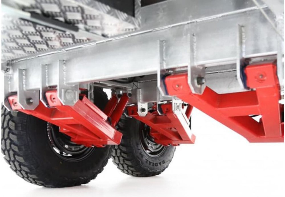

The red swing arm suspension John posted pictures of, is the system used on a lot of Australian off road caravans.  Specifically, the Black Series HQ19.  We've been discussing ways to improve the Oliver suspension, which is fine for highway and around town, but not for off-road.  Two options are possible.  One is the drop axle with spring over, that I suggested to John.  And the other is to get a Black Series HQ19.  I have opted to get a Black Series so that I can confidently go off road to places like Death Valley.  My favorite spot is over 50 miles in on a gravel road that is rough and sometimes washed out.  Then six miles across the desert with no road.
