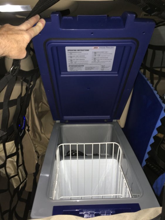

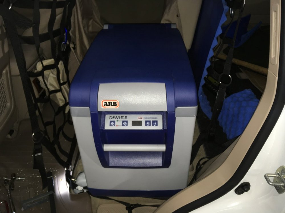

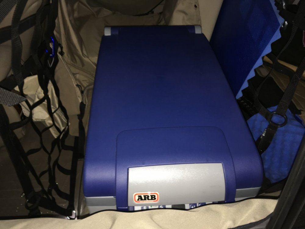

I have a mid sized ARB compressor fridge that rides behind the driver seat on long trips. I have had this unit about ten years and it has been flawless. I made a 12AWG adapter cable that plugs in my trailer’s external solar port. When stationary overnight I run the cable inside the TV to the fridge. It works fine and saves the truck battery. A 100 watt portable panel would do the same but obviously would not provide any power overnight or when shaded...
The compressor draws 2.3 amps when running on DC, and has about a 50% duty cycle on normal hot days. It runs a lot more on a sunny summer day, so I try to park in the shade and crack the windows if I don’t have it plugged into the trailer. These units need good airflow in back, so you have to be very careful not to obstruct the intake and exhaust grills with anything.

ARB fridge pics, I can easily access it through the open passenger window. Either hold up the lid, or pop it off its hinges and set it aside. Easy.

You are VERY wise to be concerned. I strap mine down using 1” ratchet straps. I fabricated stout attach points using steel plate, at the seat rail mount areas. I also have a really strong nylon cargo barrier net. This net would work great in your F250. It will not replace straps, but it is extra insurance in case you are in a bad accident. It will also restrain pets or other heavy objects that could otherwise end up in your lap, or break your neck...

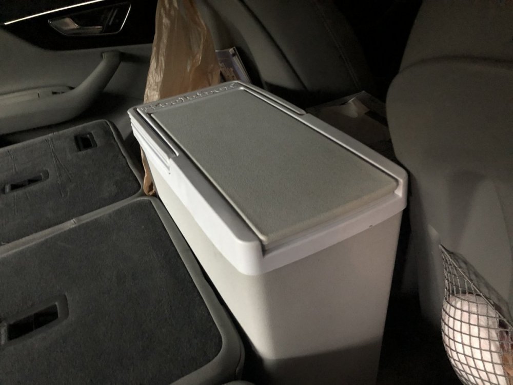

We have a small Koolatron 12V cooler that fits between the front seats and the folded-down rear seats. I selected this model because it is 8.5 inches wide, and fits perfectly in this space. It also has good reviews.
We primarily use this cooler for drinks, lunch, and snacks that the passenger can access while we are driving. On longer trips we have used the cooler to extend the capacity of the trailer’s fridge. Sometimes we have brought it into the trailer at night and plugged it into a 12V outlet. However, thus far we have only done this when we have shore power. I now know that this cooler draws 4.5 amps, so overnight use would be 81 amp-hours. Doable, but one would need to carefully monitor the batteries.
There are major differences between the ARB units and my Koolatron cooler. The ARB has an efficient compressor that draws only 2.3 amps, while mine draws 4.5 amps. The ARB also has robust insulation to help maintain temperature without power, while the info I find online suggests my unit has much less insulation. The ARB units are much better engineered, but they also cost ten times as much as mine.
Here is my idea, and I would like feedback. In another thread, Overland mentioned using a 12 volt battery pack; this item has 3 amp-hours. So I am thinking about battery packs. Sometimes we park the car and go for a hike, and as the engine is off the temperature of the cooler is not maintained. I would like to connect the cooler to a battery pack to power the cooler during the hike, and on occasion I might use the battery pack overnight. I can find more robust battery packs at Amazon, from 11 amp-hours to 38 amp-hours, that have good reviews. Would this strategy work?
