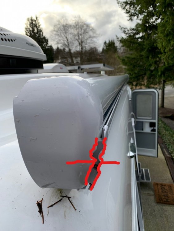

Galway Girl Posted January 29, 2020 Share Posted January 29, 2020 (edited) We picked up our Oliver Hull 505 in Aug 2019. It has on the Dometic 9500E Electric Door Side awning. Oliver University, and my physical user manuals didn't match the remote we have. Our remote looks like this below and the correct (3/2019 version) awning installation and operation manuals are attached. The installation manuals show how to adjust the slope of the awning, and also how to make sure the front of the awning is parallel to the main body of the awning. (That's very important to make sure the awning rolls aligned and smootly). I'm dealing with a different problem where the awning won't fully retract. It sticks out about 1/2 in from fully seated as in the pix below: There are motor adjustment screws at the front of the awning that are hard to reach and require a special hex tool. These are used to adjust the motor close point. (In previous generations of the case awnings this was done via "remote control button pushes.) I'm working with Service to figure this out...and I may need to build a special hex tool for this by modifying a standard hex key. The clearances to get in to this adjustment are VERY tight as the adjustment holes actually are facing the body of the trailer when mounted. More if I succeed. Hoping to NOT have to take it to a Dometic repair dealer, as the first one I was referred to by Oliver Support said they were "frankly not interested working on a trailer not bought at their dealership." 9500E Operation 3316982.000.pdf 9500E Case Awning Install 3316981.000.pdf Edited January 29, 2020 by ctshort09 2019 Elite II (Hull 505 - Galway Girl - August 7, 2019 Delivery) Tow Vehicle: 2021 F350 King Ranch, FX4, MaxTow Package, 10 Speed, 3.55 Rear Axle Batteries Upgrade: Dual 315GTX Lithionics Lithiums - 630AH Total Inverter/Charger: Xantrex 2000Pro Travel BLOG: https://4-ever-hitched.com Link to comment Share on other sites More sharing options...

Galway Girl Posted February 3, 2020 Share Posted February 3, 2020 (edited) I'm taking the trailer to a local repair facility today Poulsboro RV in Everett WA. They are one of the largest RV and Dometic dealers in the area and said they would work on the issue for us. I'll coordinate between Oliver Factory Support and the local service center on this one and report back results. *Results* - Took trailer to a local dealership Poulbro RV where they successfully did the awning motor adjustment for free. The awning now retracts fully into the case. That dealer also did the Dexter Axle recall for free. I had them do my wheel bearing repack since it was time for that to happen. Hunting the Mystery Dometic TOOL = The dealer said that Dometic Awnings motor adjustment require a flexible tool with hex key end. They also said that tool was provided to dealers by Dometic within the installation kits of awnings. I'm trying to find out what tool that actually is...and get one so if this happens again I don't have to drag the trailer to a dealer. I put the question to Jason in service. I'll update this if I find the answer to the mystery. If anyone is doing a factory tour...see if you can spot one during the tour and take a picture. Edited February 7, 2020 by ctshort09 Added follow on text. 2 3 2019 Elite II (Hull 505 - Galway Girl - August 7, 2019 Delivery) Tow Vehicle: 2021 F350 King Ranch, FX4, MaxTow Package, 10 Speed, 3.55 Rear Axle Batteries Upgrade: Dual 315GTX Lithionics Lithiums - 630AH Total Inverter/Charger: Xantrex 2000Pro Travel BLOG: https://4-ever-hitched.com Link to comment Share on other sites More sharing options...
