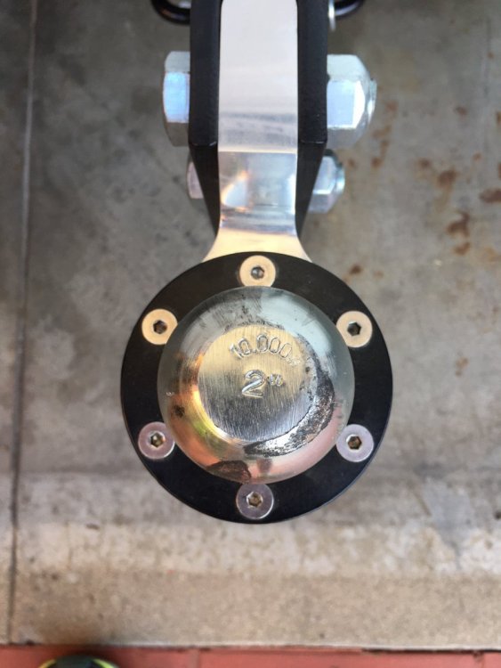

Here are a few.  At this point, the ball had about 5,000 miles on it.  I checked with Andersen said it was normal.

Here is a comparison pic, you can see the wear on the old ball. And the very obvious size and strength difference.
The ball wears very fast initially and then slows down. But the wear never stops entirely. The higher the tongue weight, and thus the higher the chain tension, the faster the wear.
Edited by John E Davies
Any one put a micrometer on one - yes it looks worn, but what does the data say???
Under the Anderson system, wear seems to be a designed in parameter. The physics of the design leads to the inevitable.
