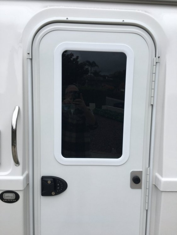

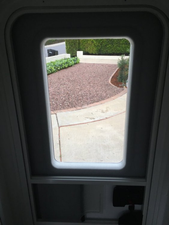

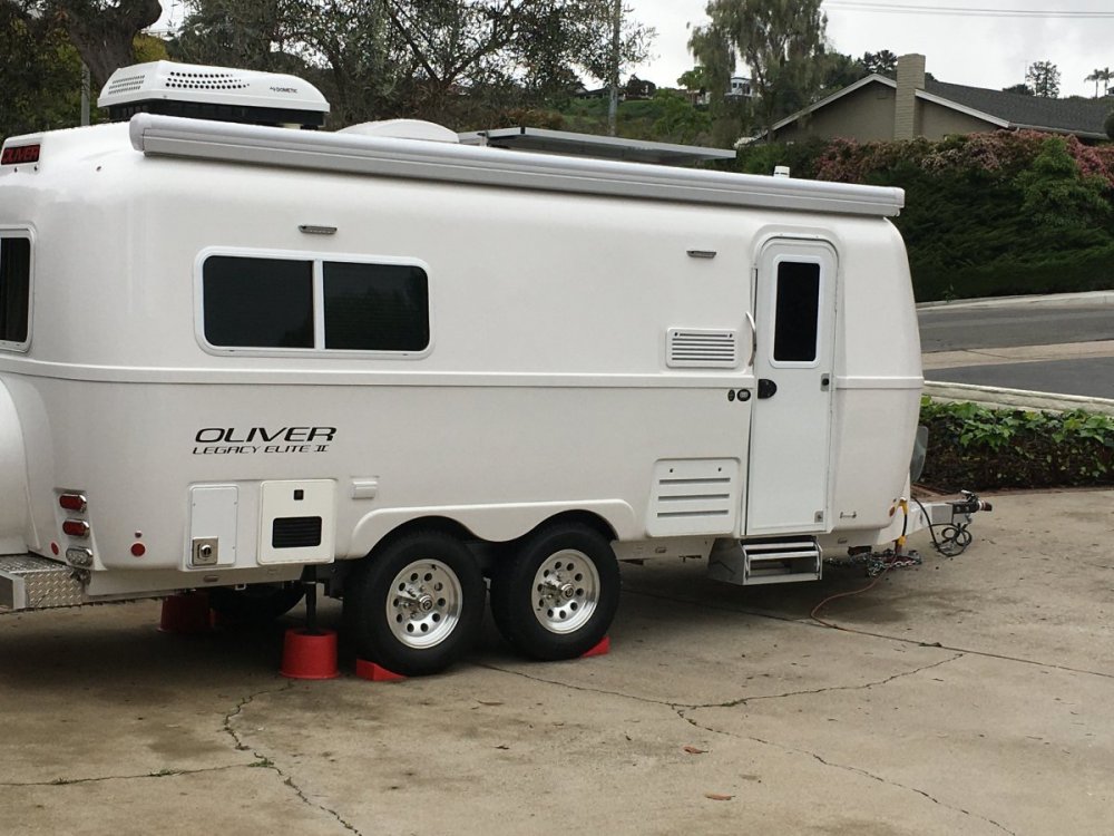

We often want to be able to look out our door window, as it is the tallest window in the trailer and would be the easiest to look out of while standing.  (I'm 6'5")
After wishing for a clear window on the door for some time, I decided to trade it out for a smoked see through window.
The glass was ordered through the LCI, the OEM of our windows. ($44.95 for the tempered glass and $20.95 for the 16 very overpriced "window keys" require to remove the interior window frame.)
The installation was simple and we think the mod is great.  We love that we can now see out the window and use it all of the time.
I am reaching out to share the mod for anyone who may be interested and ask for ideas for a innovative window treatment that aren’t easily found on the internet.

I did the install of this new window and shade this morning.  The only item that is not covered in the instructions concerns the safety glass "label" that is etched into the new tinted glass.  This label side of the glass should be placed toward the interior of the Oliver.  I chose to place it in the upper left hand corner thinking that it would be a bit less apparent there as opposed to the lower right.
I also made sure that I taped the exterior frame very well before starting the install since I was working by myself AND, if I could manage it, I didn't want to have to remove the exterior window frame from the door (this not only saves some work but doesn't disturb the existing seal on that part of the window).  This worked well other than my being a bit nervous that somehow the tape would not hold and I'd drop both the frame and window.
The new window fit exactly like the old with no gaps and the shade fit very tightly to the edges of the window.  Now I am able to see outside the door with having to open the door and I can adjust the shade (open/closed) from the inside without opening the door.

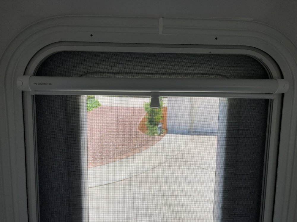

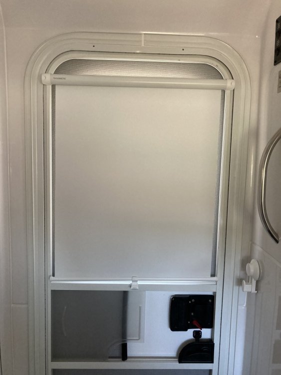

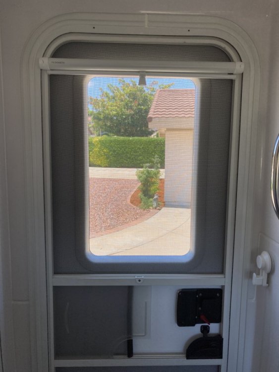

Solution found!
A custom Oceanair Skyshade Cabinshade mounted to the screen door.
It allows for full view and can be open/closed from inside.
