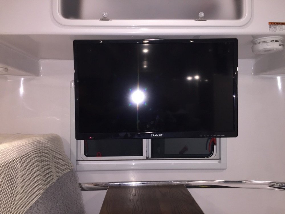

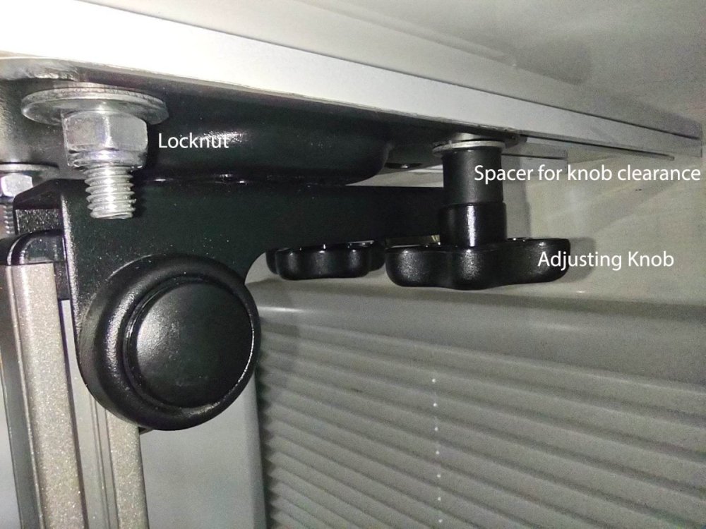

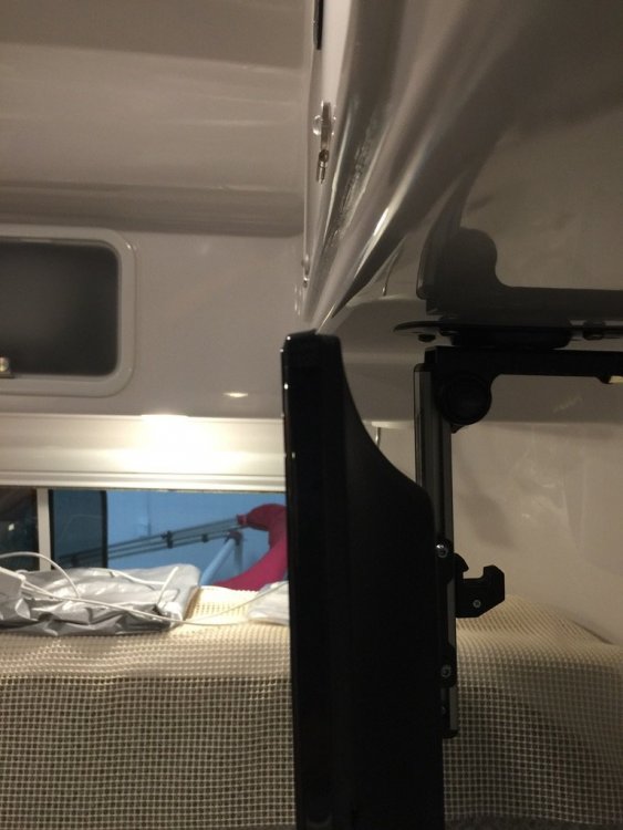

I've just replaced my 2018 original Furrion with a 28" 12 volt, Free Signal, Transit. Functionality is a big improvement but installation did require a complete recabling of the entertainment system due to cable port function and location differences. It fits fine with respect to the window shade and cable through-grommet, but it is about two inches thicker and extends forward of the overhead about an inch. I looked at moving the mount 1-1/2" to the rear but this would be quite involved due to the size of the aluminum backing plate that's epoxied to the fiberglass attic floor. I elected to just add some small vinyl bumpers to the attic door hinge buttons in order to limit the door travel and prevent an open latch from contacting the screen.

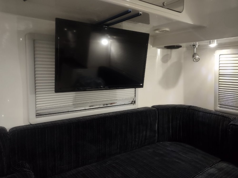

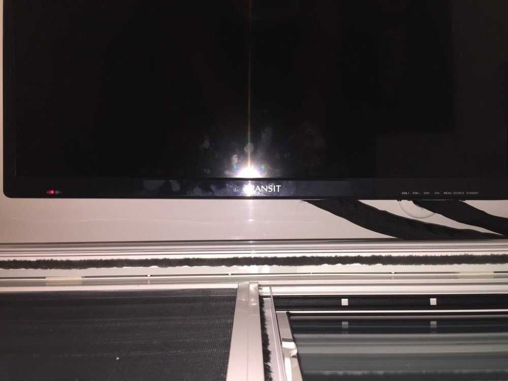

The last picture is looking up from the vanity top. Look closely and you can see how much clearance there is between the TV and window shade. I do plan to lower the TV on the mount slide the last available inch, visible in picture three. This will reduce the rear clearance when raised but there's still enough space.

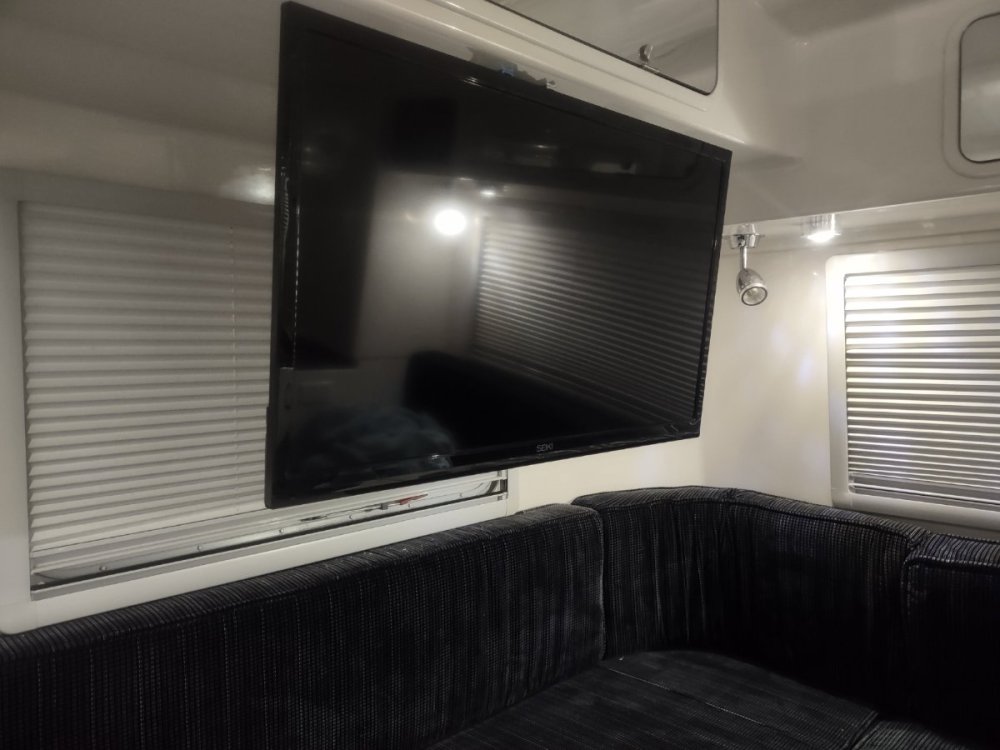

I replaced the old-school Jensen 24" that was in my Ollie when bought it with a 34" LED. Would have rather went with a 32", but decided to use a spare TV that I wasn't using instead.  I did end up mounting it on a rail system so I could slide the TV back to the rear window when in the down position since it was way too far forward for my liking without it.  Pretty happy with it but still might downsize to a 32" when this one craps out.

Don't know what type of aluminum they are made of, but they seem to be strong enough for this application. I've used it on several trips already and haven't noticed any bending of the channel lips that hold the bolt heads, but will keep an eye on that going forward.

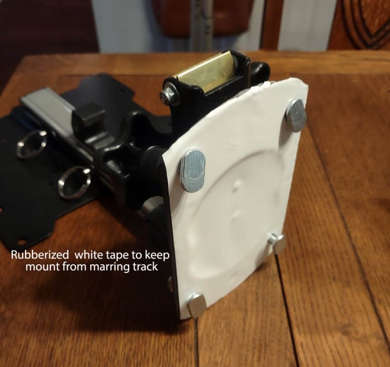

Inside the cabinet I reused the original large metal plate that the factory TV was mounted to. Countersunk the track so the screw heads were recessed and then used lock nuts inside the cabinet. I think I used 6 per side. The TV bracket itself is the same one currently used by Oliver. I used the knobs included in the track kit to mount the TV mount so I'm able to adjust the mount tightness by hand. I'll get some better pics soon.
It's actually very easy to access the rear window in case of emergency. I can grab TV, pull it forward, and then slide it right off the track which gives me more room than if the TV was there in the folded up position. This is the main reason I didn't recess the channel into the cabinet which would have looked more aesthetically pleasing, but wouldn't allow such quick access to the rear window.
My favorite part of this mod is that the TV can be slid almost to the back window and the seat space below is now usable with the TV down. Makes the space feel so much larger even though the TV is so much bigger than what was there. Almost like having a wall mounted TV.
Some more pictures of the track mount that show a little more detail. Painted the track with white epoxy enamel since last pics and it now blends in much better. The locknuts in the front of the mount are only adjusted once when installing and the two knobs in the back are used to lock the mount in place while traveling and then left slightly loose while in use to allow the easy removal of the TV and access to emergency window. Used a 4" wide piece of white rubberized tape on the back of the mount to prevent marring of the track and add additional grip when traveling.
