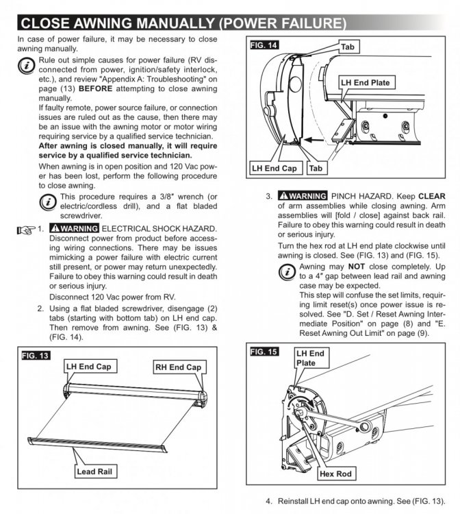

In regards to manually closing the awning..,,,, See attached scan of the manual. It can be done, it requires a flat bladed screwdriver to remove an end cap, plus a 3/8” wrench to wind it in - when done it may have up to a 4” gap so it would not be towable. Unless you could somehow keep it in place with a bunch of 1” ratchet straps. Plus it requires (professional) servicing to reset the limit switches after doing this. There is no indication that you can manually open the unit.
