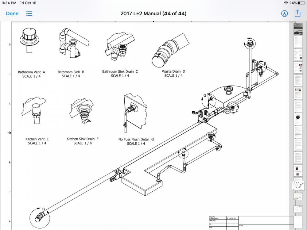

Adding to Mike's response.  This picture is from the 2017 owners manual.
Thanks for sharing this.  This layout is much different than our previous RV's where the grey tank drained in to the black tank before exiting the sewer outlet.  On our Leisure Travel Van the black tank was rear/street side, the grey tank mid/street side.  Because if was not directly above the black tank, the toilet was a marine type macerator toilet.
I assume the "no fuss flush" detail G is where you hook up a hose to flush the black tank.  The diagram makes it appear that connection is near the black tank at the front of the trailer.  Is that where you access it or is it actually in the utility center at the rear of the trailer?

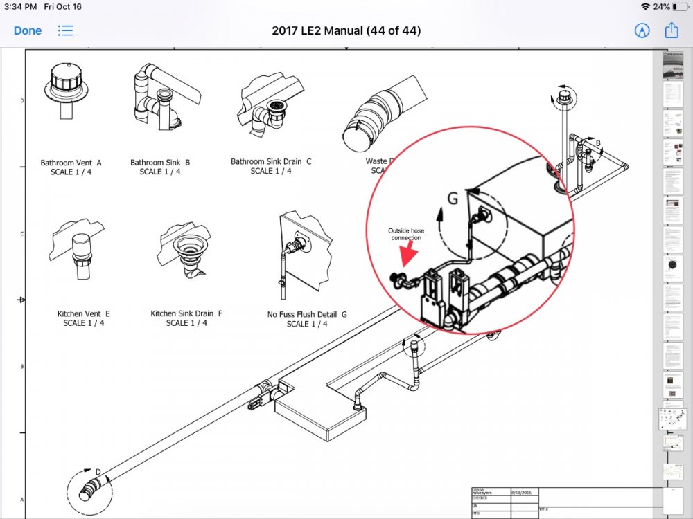

The black tank flush hose connection is located in the area of the forward dinette seat at the bottom of the hull.

Thanks!!  Makes sense that it would be near the black tank.  I'm getting used to the idea that the plumbing is different with front bathroom.  Having the bathroom in the front allows for a bigger room, while keeping the rest of the cabin open and spacious.  I don't understand why more trailers don't have this configuration - maybe cost?

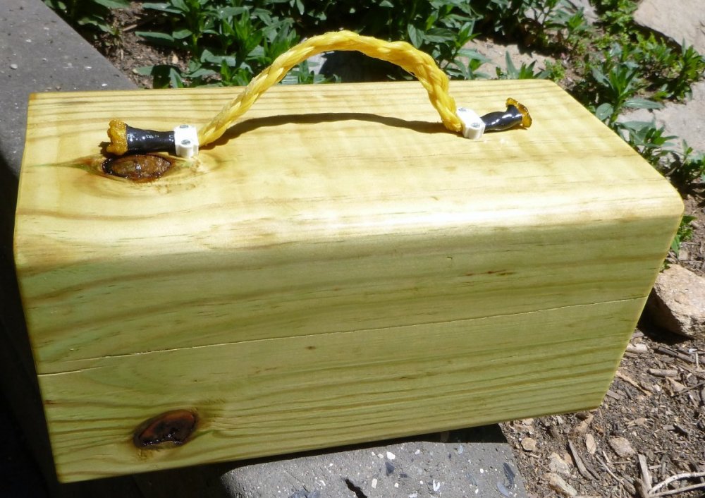

Like Bill, I made my own blocks.  Mine are stacked pieces of pressure treated 2X6’s.  I drilled a couple of holes through them and added yellow nylon rope for handles.  I usually put one or more legos under them to raise them even more.  Here’s a picture:
