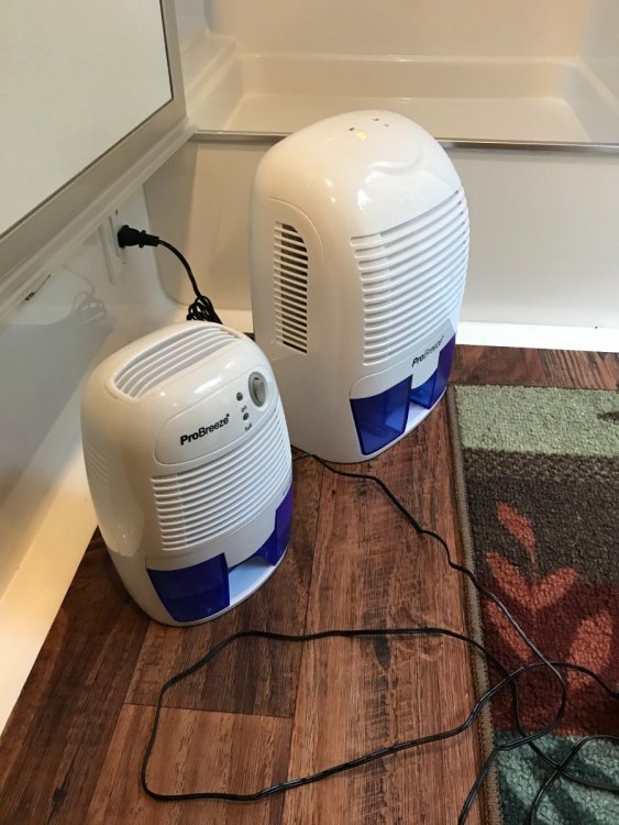

We have been using a Pro Breeze 150 SF (1200 CF) dehumidifier in our Ollie plugged into shore power while in storage here at our home. We emptied this dehumidifier every 5 days.  It just was not enough machine to get the RH down to a target range of below 50%. This smaller unit has struggled to bring the RH down to 68%. So we ordered the next size larger 250 SF (2200 CF) and are going to give it a try. Hopefully this new unit will drop the RH to less than 50%.

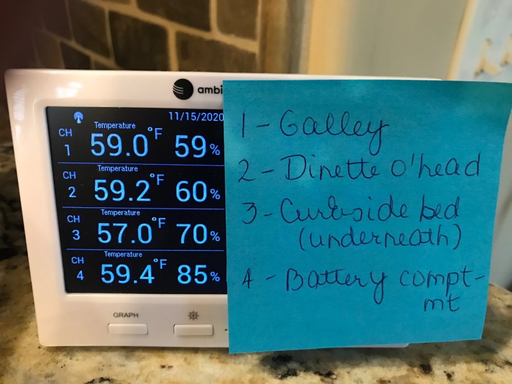

We monitor internal temp and RH humidity remotely from our home with a remote weather station - channel 1 & 2. Channels 3 under curbside bed and 4 is located in the battery compartment. Is anyone else using a dehumidifier while their Ollie is stored?

I purchased the Pro Breeze 2200 for ours, but it would not get the humidity down below 60%.  So last week I went to the local big box and picked up a 20 pint GE dehumidifier. The GE is a bit large to carry along on trips, but I am happy to report for storage it is working great.  I have it set to keep humidity  down  to 45%. It dropped the trailer to that in less than an hour.  I have had a slightly larger GE in my workshop for about 4-5 years and it has worked continuously without problem, so that is the reason I tried another GE.  I don't know how Western NC compares in humidity levels with Raleigh area. Hopefully, it is not as bad, but I am guessing it is probably the same. We will use the Pro Breeze when traveling.

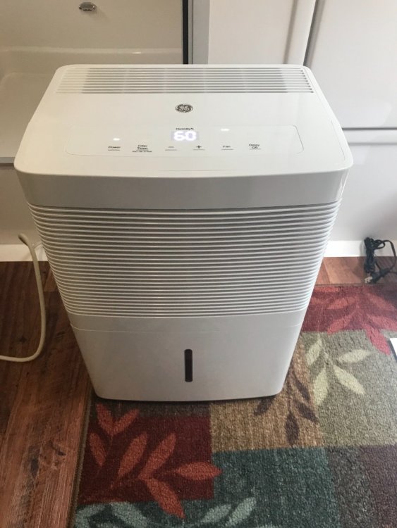

It was the HD.  Here is a link: https://www.homedepot.com/p/GE-20-Pint-Dehumidifier-ADEL20LY/310574305
The price was 159.00

**Edit with a few photos - just installed the GE unit, it’s hefty in weight - box says 33#. Instructions say to set the unit to lower H to 45-50% during first 24 hrs of operation, done. My only concern will be to ensure it does not dry out our sink, shower traps and toilet from antifreeze too quickly. We’ll monitor this for a week and see how it does. A pic showing the size comparison to the Pro Breeze. This Tuesday & Wednesday we may dip down to a freeze point, so I will need to keep an eye on the dehumidifier so that it does not freeze up. A work in progress.
-David
Readings after plugging in the GE - so we’ll watch progress.

I vote for the little guy - the smile gives it personality.  Who cares how it works 😁.

We’ll keep the smiling little guy for travel 😄. Although I think it’s not going to be very effective when we are in and out of the Ollie. It maintains about 69% RH. Better than nothing I suppose. 🥴

I just read in the owners manual not to run our new GE dehumidifier below 41 degrees or above 90 degrees😳. So with temps dipping below freezing I will just empty it and turn it off this mid week at night. The GE model has a high and low speed and it’s pretty quiet on low. A continued work in progress.
Here is the GE we purchased recommended by Ray.  We bought at HD - it’s heavier than it looks at 33 lbs empty.

Just a follow up with the GE dehumidifier listed above. We learned in the owners manual that it should not be used below 41 degrees or above 90 degrees and its heavy as a boat anchor. So we returned the unit to HD yesterday. So our search continues. We will keep the Pro Breeze for travel.
