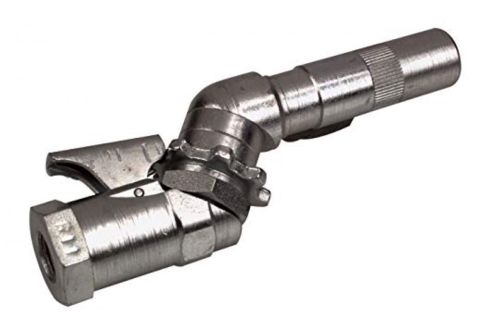

John E Davies Posted December 26, 2020 Share Posted December 26, 2020 (edited) Once you use an air powered one you will be much happier. You still have to deal with the initial airlock, when you first install the cartridge, but once that is cleared and it starts moving grease, you no longer need to find room to swing that huge lever, and you can simply hold it one handed while your other hand maneuvers the tip into position on the zerk. Then a few taps of the trigger. Done. And that Alemite swivel tip truly is a wonder, buy it now, don’t look back. You won’t need to change any of the Dexter zerks with that adapter. I serviced my suspension recently and had no problems getting to them. Have fun. John Davies Spokane WA Edited December 26, 2020 by John E Davies SOLD 07/23 "Mouse": 2017 Legacy Elite II Two Beds, Hull Number 218, See my HOW TO threads: Tow Vehicle: 2013 Land Cruiser 200, 32” LT tires, airbags, Safari snorkel, Maggiolina Grand Tour 360 Carbon RTT. Link to comment Share on other sites More sharing options...
