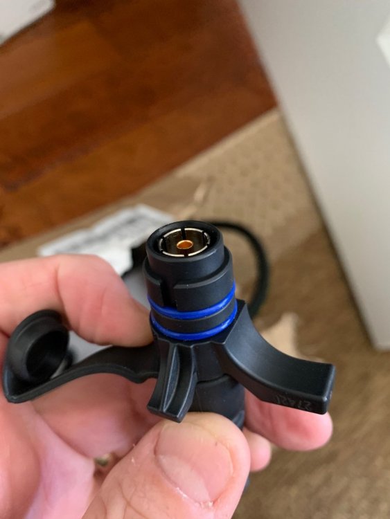

How well is the GM camera port sealed when its cable is plugged into it? The standard round one is open to water and road grit, and since that is a low pressure area, all the road spray gets sucked into that spot.
Something to research and consider maybe? At the very least, buy a can of electrical contact cleaner or isopropyl alcohol, and spray both parts regularly.
The camera plug has 2 o-rings on it so it should be water tight.

That is pretty nice, not one but two orings, I am impressed. You should still carry a proper solvent ...  CRC Electronic Contact Cleaner  ...   to spray it and the receptacle to get rid of external crud that might tear those pretty rings, and find some replacement orings that will fit, for your spares kit. Sometimes you really do get a much better product by paying extra for an OEM accessory. Not always though, for example an OEM Toyota Ball mount and ball is $$$$ and not much different from a $20 one from Amazon in quality.
Thanks for posting that pic!
