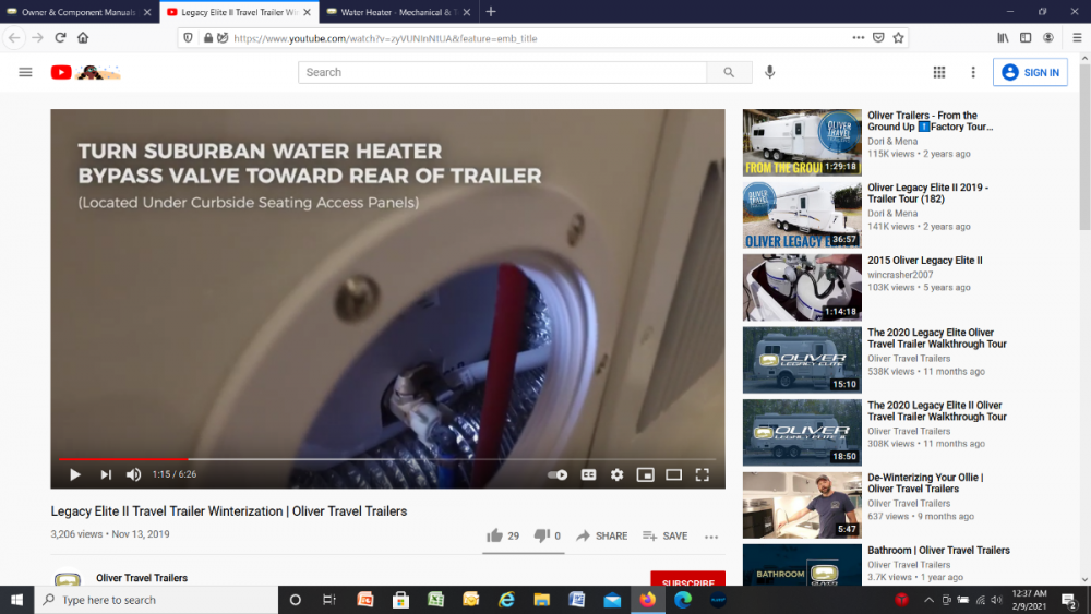

We have not had to winterize yet; nor have we drained the water heater (standard Suburban heater) after bringing our new Oliver home in December.  The other day, I decided to look for the water heater bypass valve, in the event we should need to winterize.  If it resides in the same compartment as the other plumbing valves, I can't find it.  I see the four valves in the plumbing around the fresh water tank and pump, as pictured in the diagrams under the hatch.  I can also see red and blue Pex lines going to and from the water heater, but no sign of a valve to isolate the HWH from the water supply.  Does one of the aforementioned valves serve to bypass the hot water system?  I can't seem to wrap my head around that idea.
Then there's the fresh water drain valve way down in the bottom of the hull under the heater ducting. (what a convenient place; I wonder who came up with that?).  Are you supposed to be able to reach this through the access port just to the left of the furnace air intake?  If not, what is that access port intended for?
If someone could puh-leeze help me locate the HWH bypass, I'd be forever thankful.  Perhaps putting the water system valves in Winterize configuration takes care of bypassing the HWH? That would be simple 😀

Susan, our bypass valve requires lifting the seat hatch.  I have a 2008. It's not easily visible,  but identifiable in the chart. Which, we have to look at every year, because we do it so infrequently.
Our bypass is pretty much hidden under other plumbing runs, but it's there.
Maybe next year, I'll tie a ribbon on ours.
Good luck .
Sherry
It's down by the furnace ducting... I have to move the duct to see the brass valve.

13 hours ago, SteveCr said:
Here is the winterization link....water heater bypass valve at about 1:00.
https://www.youtube.com/watch?v=zyVUNInNtUA&feature=emb_title
Thank you, greatly, for the photo . . . . when I open the access port the heater duct is between the port and the water heater (where the valve should be).  Do you push the heater duct down to reach the valve?  Or up?  I wish I would have asked this question during walkthrough; there are so many questions you don't know to ask until after you have used your Oliver for a bit.
Edit: watching the video, it seems the access port is mainly for recording the process!  It would be very hard to reach through the hole, while laying on the floor, to turn the valve!  And they make it look so easy to lift up the mattress to get to the hatch.  I'd love to hear how others have mastered the technique of opening the seat hatches while holding the KTT mattress up and out of the way?

A mattress can be tilted 90 degrees and pushed out toward the wall, that will give enough clearance to lift and pull out the access panel underneath it. My mattresses are 10 inches thick, and it works for them. It does help a LOT if the bed is not fully made up with sheets, blankets, bedspread, comforter and dog on top. I sleep in a cool weather bag with liner, there is just a fitted protective cover over the mattress.
Don’t be afraid to carefully shift an air duct out of the way, just do not abuse it or poke a hole in it.
