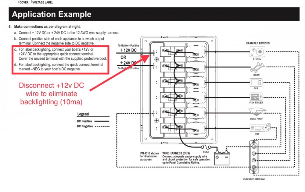

John E Davies Posted March 12, 2021 Author Share Posted March 12, 2021 (edited) I found a possible way to eliminate the Blue Sea 5376 rear circuit breaker LED lights. Has anybody tried this? I started a Service Ticket asking about disabling the lighting. EDIT - Service says that removing that lighting wire will work. It should be simple enough (remembering to cap or insulate the loose hot wire).... Thanks, John Davies Spokane WA Edited March 15, 2021 by John E Davies 1 "Mouse": 2017 Legacy Elite II NARV (Not An RV) Two Beds, Hull Number 218, See my HOW TO threads: https://olivertraveltrailers.com/topic/john-e-davies-how-to-threads-and-tech-articles-links/ Tow Vehicle: 2013 Land Cruiser 200, 33" LT tires, airbags, Safari snorkel. Link to comment Share on other sites More sharing options...

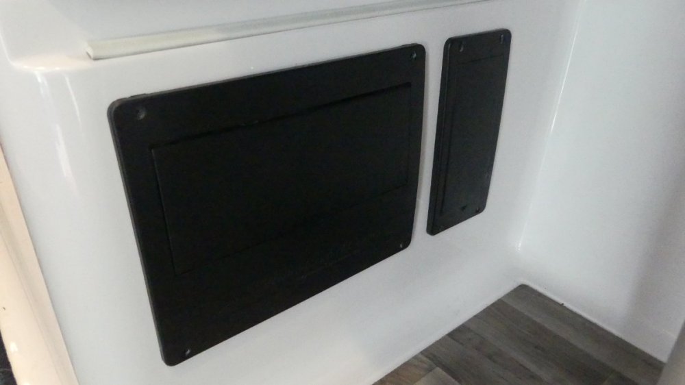

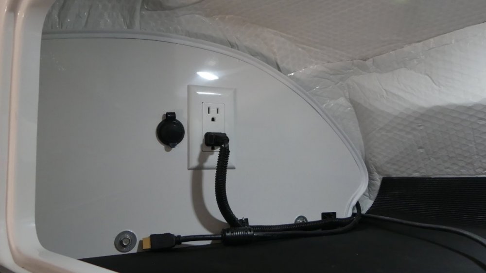

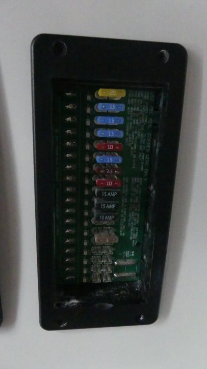

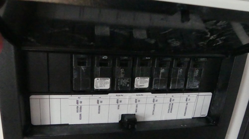

Ray and Susan Huff Posted March 15, 2021 Share Posted March 15, 2021 (edited) 23 hours ago, John E Davies said: LOL, “infamous” thank you very much, now I feel like a bank robber. That is the rear circuit breaker panel installed in the street side of the rear overhead compartment AKA “the attic”. If you don’t have that particular unit (it is extremely high quality and about $220) then there is probably something very similar. Take a look and let us know, maybe post a pic..... John Davies Spokane WA Where in relation to the PI surge protector display? All I can see in the attic is the outlet for the TV, USB/12v plug and the surge protector display. Both sides of the attic are faced with a rigid panel, set out a bit from the side wall with connecting bolts at the bottom. If there's a breaker panel there, it isn't easily accessible. However, I think I remember seeing two panels under the rear dinette seat. This brings up another question: Does anyone know what the HDMI and coax cables in the attic are for? I know they probably have something to do with the entertainment system, but what? We don't have the TV antenna or Satellite, just cable connection. I need to read the manual, I guess. It's just that I usually can't find the answer to my questions there 😠 Edited March 15, 2021 by Ray and Susan Huff forgot to attach pictures Ray and Susan Huff Elite II Twin "Pearl" - Hull#699; delivered December 7, 2020 2013 F350 6.7l diesel Super Duty 4x4 long bed crew cab 1UP-USA Heavy-duty bike rack 2017 Leisure Travel Van Unity Twin Bed (sold) Link to comment Share on other sites More sharing options...
Ray and Susan Huff Posted March 15, 2021 Share Posted March 15, 2021 The rear dinette seat has the Progressive Dynamics Power Control Center (breaker box) and Fuse panel. I don't see any light display, though. The front dinette seat has 12v plug, USB plug, CO/LP monitor, and electrical outlet. Ray and Susan Huff Elite II Twin "Pearl" - Hull#699; delivered December 7, 2020 2013 F350 6.7l diesel Super Duty 4x4 long bed crew cab 1UP-USA Heavy-duty bike rack 2017 Leisure Travel Van Unity Twin Bed (sold) Link to comment Share on other sites More sharing options...
Ray and Susan Huff Posted March 15, 2021 Share Posted March 15, 2021 Looks like this breaker panel and this fuse panel Ray and Susan Huff Elite II Twin "Pearl" - Hull#699; delivered December 7, 2020 2013 F350 6.7l diesel Super Duty 4x4 long bed crew cab 1UP-USA Heavy-duty bike rack 2017 Leisure Travel Van Unity Twin Bed (sold) Link to comment Share on other sites More sharing options...
John E Davies Posted April 7, 2021 Author Share Posted April 7, 2021 (edited) EDIT: disconnected the Blue Sea CB panel backlight. .... https://olivertraveltrailers.com/forums/topic/5405-how-to-disconnect-the-attic-blue-sea-circuit-breaker-backlight-10-milliamp-phantom-drain/ John Davies Spokane WA Edited April 7, 2021 by John E Davies "Mouse": 2017 Legacy Elite II NARV (Not An RV) Two Beds, Hull Number 218, See my HOW TO threads: https://olivertraveltrailers.com/topic/john-e-davies-how-to-threads-and-tech-articles-links/ Tow Vehicle: 2013 Land Cruiser 200, 33" LT tires, airbags, Safari snorkel. Link to comment Share on other sites More sharing options...
Galway Girl Posted April 7, 2021 Share Posted April 7, 2021 (edited) Ray and Susan - the pix John is posting are of things likely not in your trailer either because he's added them or they from the earlier model year EII's. Earlier models up through 2019 had a Progressive Dynamics 4000 Energy Center under our Dinette Seat. (PD4000 Energy Center under dinette seat, but with Cover OFF) - The PD4000 unit housed AC Breakers, SOME DC fuses (but not all) and the power Converter that charges our batteries. The rest of the DC Fuses were in a small fuse box in the attic next to the surge protector display. In the newer models like yours they switched to a new set of energy panels for AC Breakers and DC Fuses (all in one convenient place under the dinette) as shown in your pix. They also changed to either a 2000 W or 3000 W combined Xantrex inverter/charger...which is able to be programmed for a charge profile for Lithium Batteries from a variety of vendors. So looking at some of our posts for other pre 2020 unit pictures could be a bit confusing if you are thinking your missing some new or special feature. Craig Edited April 7, 2021 by Galway Girl 2 2019 Elite II (Hull 505 - Galway Girl - August 7, 2019 Delivery) Tow Vehicle: 2021 F350 King Ranch, FX4, MaxTow Package, 10 Speed, 3.55 Rear Axle Batteries Upgrade: Dual 315GTX Lithionics Lithiums - 630AH Total Inverter/Charger: Xantrex 2000Pro BLOG: https://4-ever-hitched.com Amazon Oliver Outfitters Guide: https://amzn.to/2mAAgPO Link to comment Share on other sites More sharing options...
Moderators SeaDawg Posted April 8, 2021 Moderators Share Posted April 8, 2021 3 hours ago, Galway Girl said: So looking at some of our posts for other pre 2020 unit pictures could be a bit confusing if you are thinking your missing some new or special featur This is so true. Older models, and newer models, have different equipment. Thanks for pointing that out, @galwaygirl 1 2008 Ram 1500 4 × 4 2008 Oliver Elite, Hull #12 Florida and Western North Carolina, or wherever the truck goes.... 400 watts solar. Dc compressor fridge. No inverter. 2 x 105 ah agm batteries . Life is good. Link to comment Share on other sites More sharing options...
