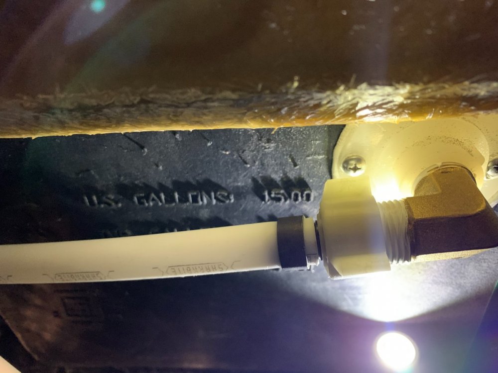

- Black water tank - this tank holds 15 gallons before full.  The documentation says this tank is supposed to hold 18.5 gallons (note that the tank has "15 US Gallons" stamped right on it).

The real bummer is the grey water is our limiting camping factor at the moment and now that I've got an easy way to use my black tank for grey water I'm not able to use 6 gallons of grey capacity (2.5 gallons in my grey tank and 3.5 gallons in my black tank).  I opened a case on my black tank.  It really "stinks" (pun intended) that my black tank is only 15 gallons and it's supposed to be 18.5.  😞  I wonder how many other 15 gallon black tanks are out there.

My black water tank is the same as yours.. I’ve wondered about the other 3.5 gallons of “of capacity “ as well.. I don’t think there is that much volume  between the tank and black water valve...

Good catch.  It appears that Oliver noted your post highlighting the 18.5 gallon vs. 15 gallon discrepancy.  I have a 2022 on order, so after reading your post, I checked the specs for the 2022 Elite II:
15 Gal. Design Capacity Black Water Tank with pressure flushing system for the Tank     Standard
So, maybe thanks to you, new buyers like me are on notice that they are getting only 15 gallons, and maybe less, depending on the difference between actual and "design" capacity.

I think the "design capacity" in the older trailers  included the volume contained in the pipe between the valve and toilet. That can be considerable, depending on where the valve is/was. I'm pretty sure we get an extra 3 to 4 gallons in our older Ollie, in the pipe. The math isn't that difficult,  just never had to figure it out.
