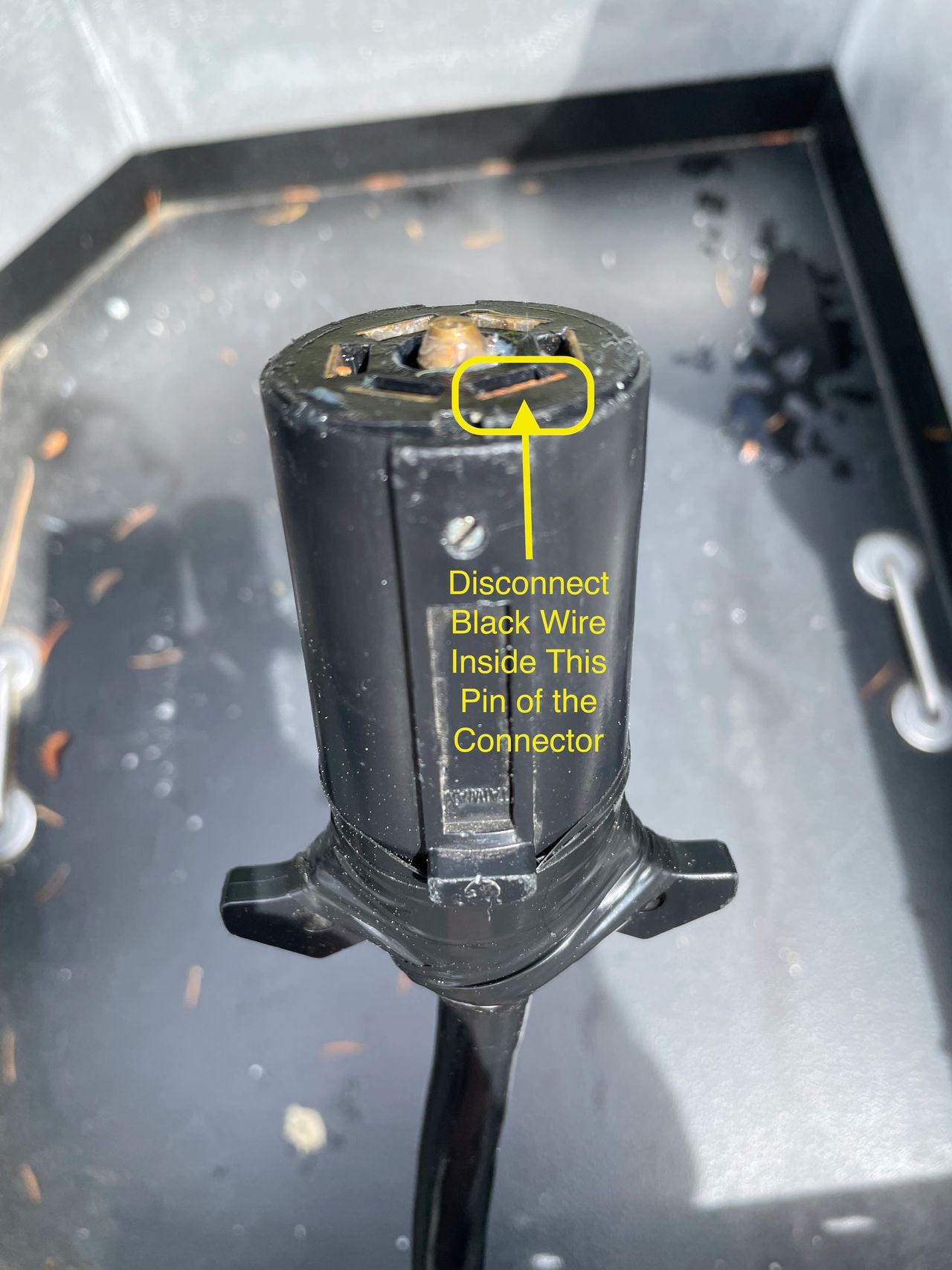

Step 7;
Disable the 7 Pin Charge Line:
We will be installing a new DC/DC charger into our Oliver EII.  But before we do that install  we need to disable the current charging wire that runs from the 7 pin cable on the tongue of the Oliver.  That 7 pin connector is the one that plugs into the back of the truck for lights, brake lights, emergency brake power.
Inside the 7 pin cable there is a BLACK wire that provides 12V (B+ )  from the truck battery/alternator B+ all the way back through the trailer, through a 20A breaker and back to the batteries via the 12V Bus bar in the trailer.
We will not be using that (Black) charge line for the trailer an longer.
We disabled that line on the 7 pin connector by putting heat shrink coating over the screw terminal on the black B+ wire conductor and also taping up the screw lead the body.  We reassembled the conductor and tested that no 12V was present on the wires inside the trailer.

To disable the Charge Wire (BLACK) from the 7 pin, remove the cover and disconnect the wire from the connector by taping up the wire and putting it back inside the cover.  Don't cut the wire in case you need to use it in the future.
7 Pin Connector from Trailer
