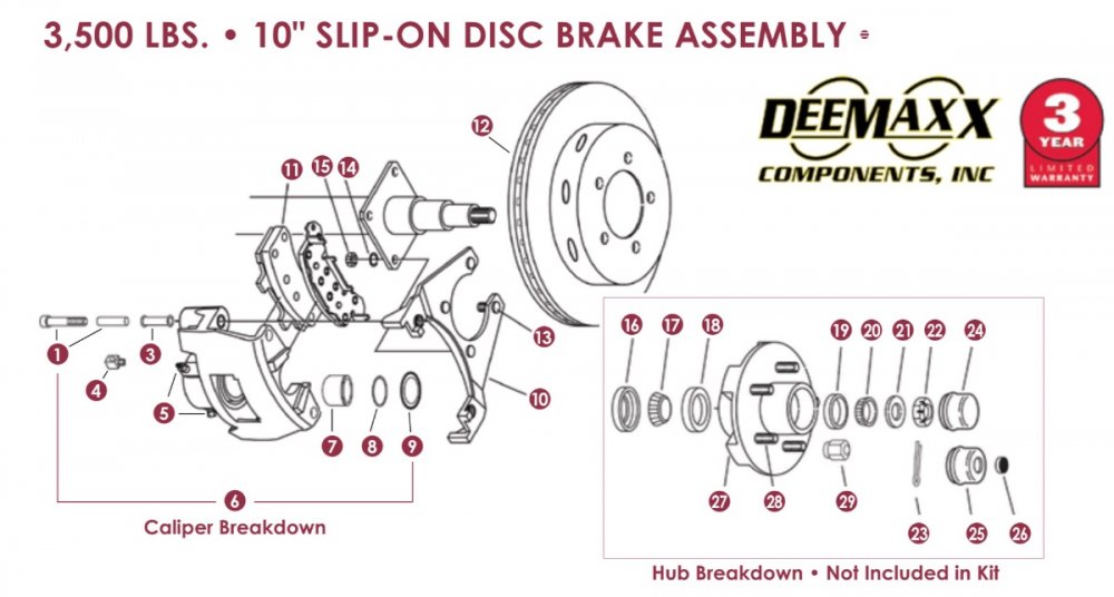

Here is the 10” Dexter slip-on kit (5 hole wheels):

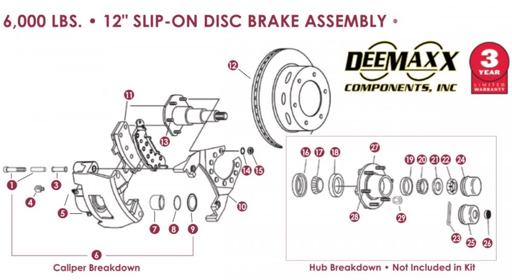

And the 12” kit (6 hole wheels, HEAVY parts):

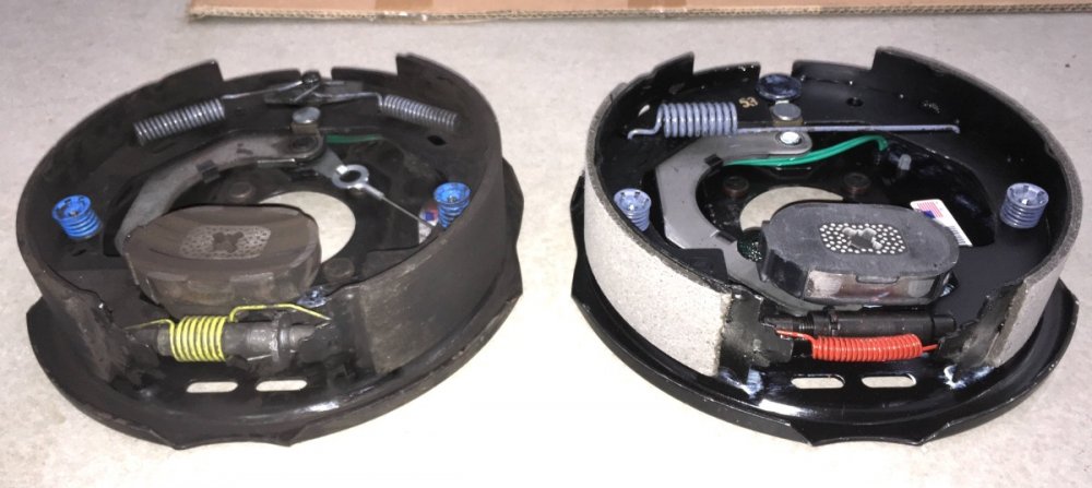

Are the brakes on our trailers self-adjusting or manual adjust?  I have mine inspected annually when I get my bearings repacked.  I can adjust my brake controller so that the wheels skid when I squeeze the controller.  With my new truck I have the BC set on 6 and I get a good tug from the trailer when I squeeze the controller.  My brakes are 5 years old with 60K miles.  Last spring my maintenance guy said they were almost down to half.  Now that we’re home from our spring trip I’ll be taking it in for the annual check.
The "easy" way to tell is to take a look at the back of the drum.  If there is a rubber plug take it out and look for a "wheel" on the inside of the drum that can be turned (via the notches in the wheel).  Turn it one way and the brakes tighten while turning it the other way loosen the brakes.  These are manually adjusted brakes.
Since I'm hull number 117 and you (Mike) are fairly close, I'd guess that you have the same brakes as I do - self adjusting.  Basically these brakes adjust each time you drive the Oliver in reverse.  These are not as finely tuned as the current Dexter "never adjust brakes", but, generally they do a good job.  This is particularly so if during your annual wheel bearing job the brakes are adjusted properly when you hub is put back on.  Right after this annual job your first few stops just might be a bit lacking in stopping power - that is because you probably haven't backed up the Ollie enough times yet in order to allow the self-adjusting mechanism to full work its magic yet.
As long as the big magnet inside the drum is still good, the magnet is getting power, and, you have reasonably good brake lining, you should be able to get more that reasonable stopping power from drum brakes under "normal" circumstances.  Yes, this is arguably ancient technology.  Yes, disk brakes are easier to service and can provide more consistent and reliable stopping power under a broader array of circumstances.  But, properly serviced drum brakes have proved to be a reliable source of stopping power for many years on many vehicles and trailers.
