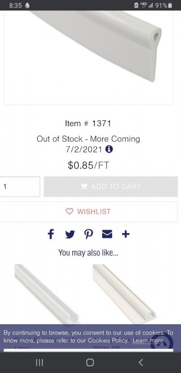

The discs on our boat seatback look like these from sailrite. They're meant to be screwed into wood, but vhb or command tape should work fine. Then cut strips or circles of the hook side, and sew or fasten to the cushion.
I read once about a guy who sewed bolt rope to his cushions, and glued flexible  awning track to the seatback of the cockpit. That would surely be a pain to remove and reset any time you needed access to the areas under the seat, but it sure would keep the seat cushions in place.
Sailrite photo.
