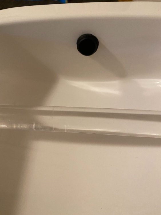

2008RN Posted August 30, 2021 Posted August 30, 2021 Does anyone know a source for the bathroom waterproof switch. There are 2 switches; the pump switch and the light switch under the cabinet. I was thinking about putting in a switch to turn the composting toilet fan on/off. Early 1999 Ford F250 SD 7.3L Diesel 2020 Elite II Twin - Hull # 648
2008RN Posted August 30, 2021 Author Posted August 30, 2021 I just had another thought. Is the switch in the bathroom for the pump really necessary? It seems redundant with the pump switch on the SeaLevel II Tank Monitor. I could just use the present pump switch in the bathroom for a Compost fan switch. Early 1999 Ford F250 SD 7.3L Diesel 2020 Elite II Twin - Hull # 648

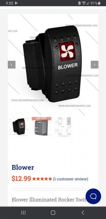

Moderators SeaDawg Posted August 30, 2021 Moderators Posted August 30, 2021 The original Elites, like our 2008, don't have a pump switch in the bathroom. It has never bothered me, as it's one step in our small trailer to reach the switch by the SeeLevel. A few original owners added a switch in the bath, and Oliver adopted the idea. (Pretty sure Scubarx and dckiefer added the switches early on.) You should able to find a similar weatherresistant switch and boot at NAPA, but if it were me, I'd spend a few dollars more and buy a weatherproof labeled blower rocker switch at a marine supply. I'd be less likely to accidentally turn off the fan. Do the new Olivers still have the little low light that illuminates the floor? If so, I'd borrow that circuit instead. We never use that light, and you'd still be able to run the blower if you turned off the main pump switch, as we do every time we leave the trailer. 2 2008 Ram 1500 4 × 4 2008 Oliver Elite, Hull #12 Florida and Western North Carolina, or wherever the truck goes.... 400 watts solar. DC compressor fridge. No inverter. 2 x 105 ah agm batteries . Life is good.
bhncb Posted August 30, 2021 Posted August 30, 2021 13 hours ago, 2008RN said: Does anyone know a source for the bathroom waterproof switch. The switches themselves are the same as used elsewhere in the trailer and are not waterproof. An optional splash-proof boot is used on the bath switches. On my 2018, Oliver used ZF/Cherry RR and SR series switches , part numbers: RRA32H3FBBNN (DPST for light) and SRJ23A3BBBNN (SPDT for water pump 3-way). The optional boot is p/n 00150751. For later model trailers, I'd recommend pulling one of the more accessible switches by the door and verifying mfg and numbers. It might be easiest to just source them from Oliver but Digikey stocks them I believe. 1
