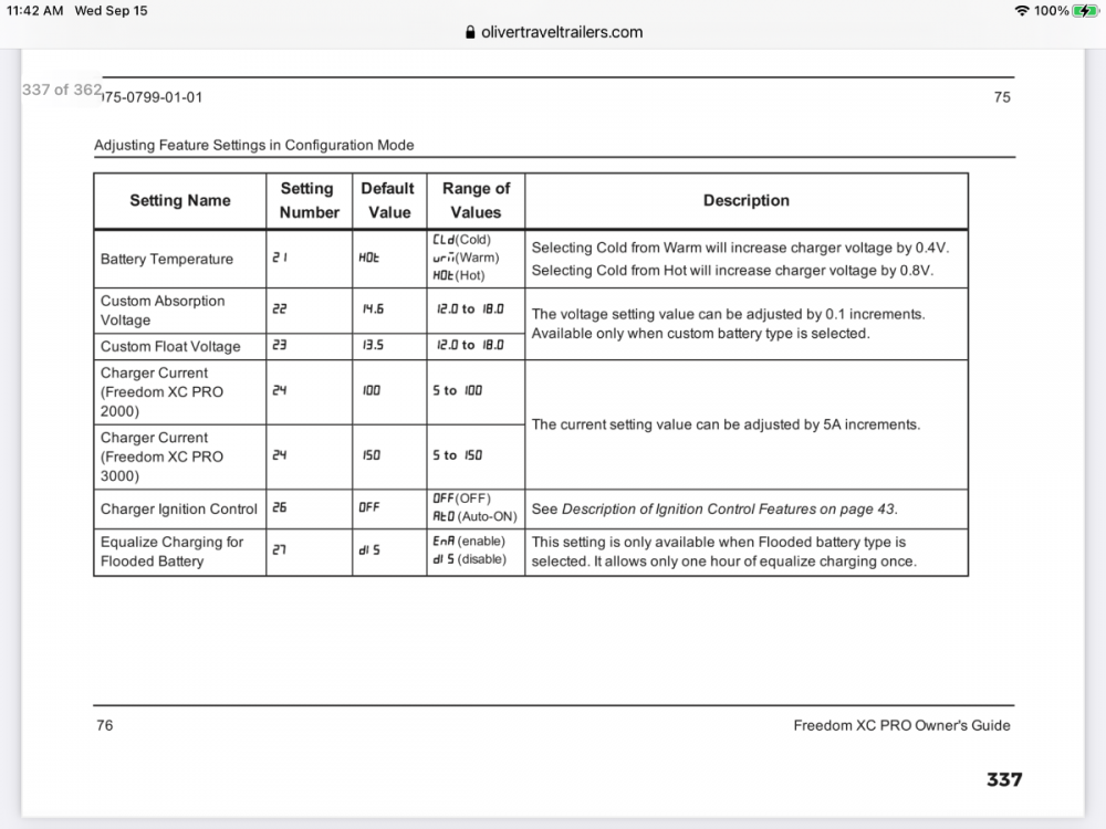

John E Davies Posted September 15, 2021 Share Posted September 15, 2021 I am sure that somebody with one of your inverter/ chargers will chime in, but you can adjust the charge rate to the batteries, default is 150 amps I believe, if yours is the 3000 model.. That probably is way too high a setting for your generator to handle. Go into the configuration settings and change it to 50 amps, see if the generator will stay online. If so, increase the setting higher until it won’t stay on. Go back say 10 amps and call it good. This is off the top of my head. Be aware that turning down the charge rate for use with your too small generator also affects when you are hooked up to shore power. If yours is the Harbor Freight Predator, it only puts out 1600 watts continuous, about 13 amps, that is very marginal for charging a large lithium battery bank. John Davies Spokane WA 1 3 SOLD 07/23 "Mouse": 2017 Legacy Elite II Two Beds, Hull Number 218, See my HOW TO threads: Tow Vehicle: 2013 Land Cruiser 200, 32” LT tires, airbags, Safari snorkel, Maggiolina Grand Tour 360 Carbon RTT. Link to comment Share on other sites More sharing options...

Jim_Oker Posted September 15, 2021 Share Posted September 15, 2021 Yeah I found I was tripping the home AC circuit I plug the trailer into periodically sometimes when it's doing bulk charging, so I dropped the "AC input breaker" setting from 30A to 14A (It's a 15 amp circuit but also has some commonly used LED bulbed lights on it so one amp to spare seems to be giving me enough buffer). Oliver has an article that mentions that we may want to adjust this setting when not plugging into 30 amp circuits including the case of using some generators. I found this easiest to change via the Xantrex app on my phone btw. From reading John's comment, I'm surmising that the relevant setting may have a different name depending on whether you have one of the the Freedom XC Pro 2000/3000 inverter models or an older model. 2 Jim and Yanna, Woodinville WA 2004 Ford E250 camper conversion Oliver Elite II hull #709 Link to comment Share on other sites More sharing options...

NCeagle Posted September 16, 2021 Share Posted September 16, 2021 15 hours ago, John E Davies said: I am sure that somebody with one of your inverter/ chargers will chime in, but you can adjust the charge rate to the batteries, default is 150 amps I believe, if yours is the 3000 model.. That probably is way too high a setting for your generator to handle. Go into the configuration settings and change it to 50 amps, see if the generator will stay online. If so, increase the setting higher until it won’t stay on. Go back say 10 amps and call it good. This is off the top of my head. Be aware that turning down the charge rate for use with your too small generator also affects when you are hooked up to shore power. If yours is the Harbor Freight Predator, it only puts out 1600 watts continuous, about 13 amps, that is very marginal for charging a large lithium battery bank. John Davies Spokane WA I suspect John has hit the nail on the head with the Charger current being set at 150 amps when the 1600 W the generator is running at is only able to support 133.33 amps (at 12V) theoretically. Given losses, I would predict that you can still use the 1600 Watts at 120V (13 amps) to charge your batteries at 100 amps (12V) without issue. I charge my pair of 200ah lithiums all the time at 40 amps (12V) because I have the time and I can - that fills my batteries at about 10% per hour. I'm not positive what John means by stating 13 amps (at 120 Volts) is marginal for lithium - I guess it's marginal if you only have a limited amount of time and 100 amps per hour is going to take too long - otherwise from my understanding you can charge lithium as slowly as you want - in fact, it's better for the ions / longevity if you charge at a lower amperage. 2 1 2020 Elite II, Hull 688 --- 2021 Silverado 2500HD, 6.6L Duramax Diesel Link to comment Share on other sites More sharing options...
Jim_Oker Posted September 16, 2021 Share Posted September 16, 2021 There may be two ways to skin the cat - it appears that setting the "input breaker" amperage (110 AC) is a valid route for the generator scenario based on the article from Oliver that I linked in which they specifically mention generators as one use case for changing the setting. 1 1 Jim and Yanna, Woodinville WA 2004 Ford E250 camper conversion Oliver Elite II hull #709 Link to comment Share on other sites More sharing options...
