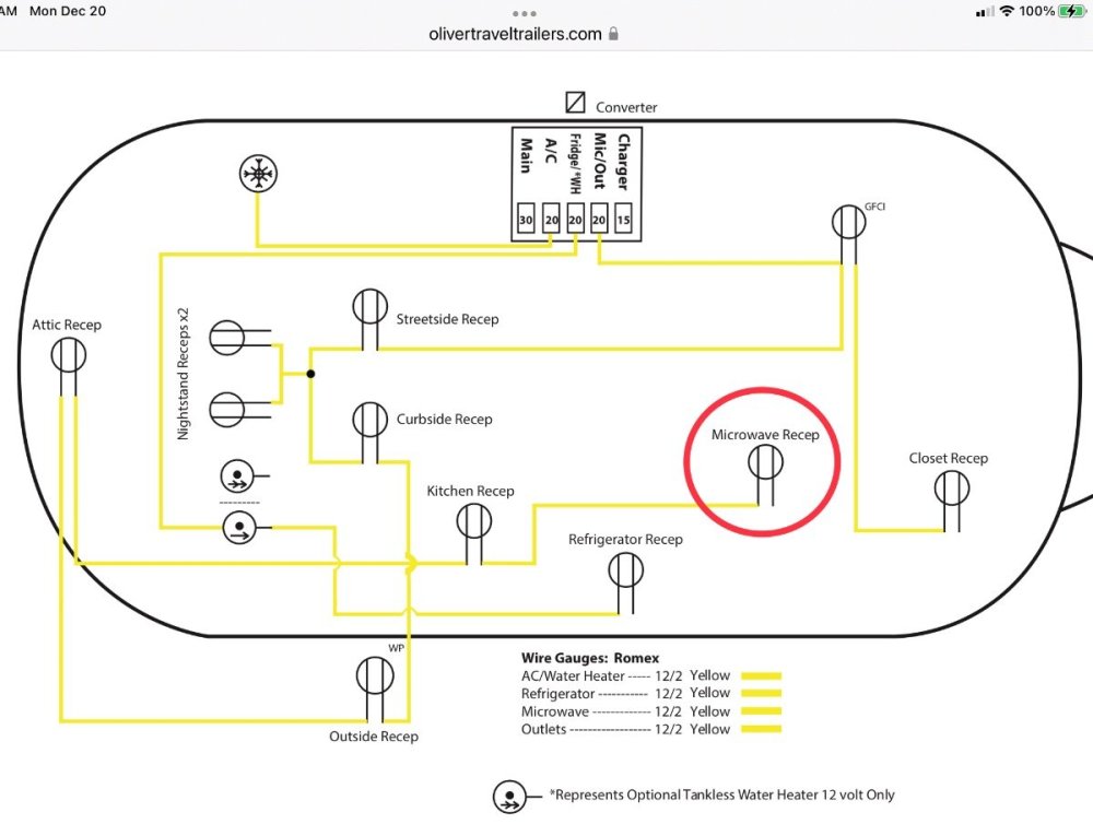

John E Davies Posted December 20, 2021 Share Posted December 20, 2021 I can’t comment on the newest trailers, but mine has that outlet shared with all the other 120 VAC ones on a 20 amp circuit. If yours is like this 2019 diagram, you won’t have any worries about overloading it, as long as you are careful not to run other high load devices at the same time, like a toaster. You could use any of the outlets. I doubt that you will be able to operate it inside that cabinet due to ventilation and heat concerns. The LE2 has a bare minimum of counter space. You could get a (slightly) larger Foy dinette table top for extra room and do your prep there. It seems overly complicated to me, for such a small interior volume, but I think you could figure it out, if you are determined. My wife loves to bake bread, at home she uses vast amounts of counter space. There is no way she could do that in our trailer. She would start screaming in frustration.🤬 Storage for all those pans, utensils, components and so on is another problem, but they could go in a great big bin and store in the truck. There isn’t room in the Ollie, and cleaning all that bulky stuff in the galley will be challenging.. John Davies Spokane WA 1 1 SOLD 07/23 "Mouse": 2017 Legacy Elite II Two Beds, Hull Number 218, See my HOW TO threads: https://olivertraveltrailers.com/topic/john-e-davies-how-to-threads-and-tech-articles-links/ Tow Vehicle: 2013 Land Cruiser 200, 32” LT tires, airbags, Safari snorkel, Maggiolina Grand Tour 360 Carbon RTT. Link to comment Share on other sites More sharing options...
snakeriveridaho Posted December 20, 2021 Author Share Posted December 20, 2021 Thanks John, that is very useful! Kirk and Carrie Peterson Twin Falls, Idaho 2018 Ram 3500, with overland conversion: Rooftop tent, water, stove, Battle Born batteries, lockers, onboard air, raised air intake, Warn winch. 2023 Elite 2, twin beds, delivered December 5, 2022 Truma package, lithium platinum package. Hull #1305 Link to comment Share on other sites More sharing options...

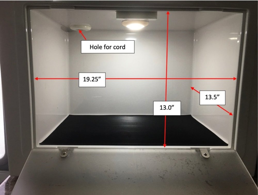

Fritz Posted December 20, 2021 Share Posted December 20, 2021 1 hour ago, Kirk Peterson said: Does anyone have the dimensions of the cabinet opening when you opt for no microwave/convection oven? The storage cabinet in a 2021 LE2 is 19.25" W, 13.0" H, and 13.5" D. You can request a hole in the roof of the cabinet that goes to a 120V outlet in the cabinet above. I agree with the other responses: you'd want to be careful with oven temperatures. We keep an instant pot in the storage compartment. On slow cook, no problem. We put the instant pot elsewhere (e.g., outside, or on the table) for pressure cook. 2 2 2021 Oliver LE2 Ram 2500 diesel Link to comment Share on other sites More sharing options...
Fritz Posted December 20, 2021 Share Posted December 20, 2021 You might also want to confirm that the cabinet-instead-of-microwave option is still available; I was under the impression that 2021 was the last year for this. Also, temporarily sliding an oven away from the back wall while in use may not be an option in that the bottom the cabinet door when open is about 1/2 in above the cabinet floor, and the top of the door when open extends about 4.5" beyond the counter into the isle. 1 2021 Oliver LE2 Ram 2500 diesel Link to comment Share on other sites More sharing options...
