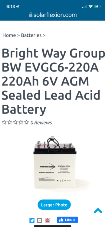

I don't specifically know if the Brightways are gel or not but from the description below it would appear that they are AGM.
This sealed lead acid battery is an non spillable, deep cycle, maintenance-free, valve regulated (VRLA), rechargeable battery. Able to be used with a wide variety of applications; it has a wide operating temperature, long service life and deep discharge recovery.

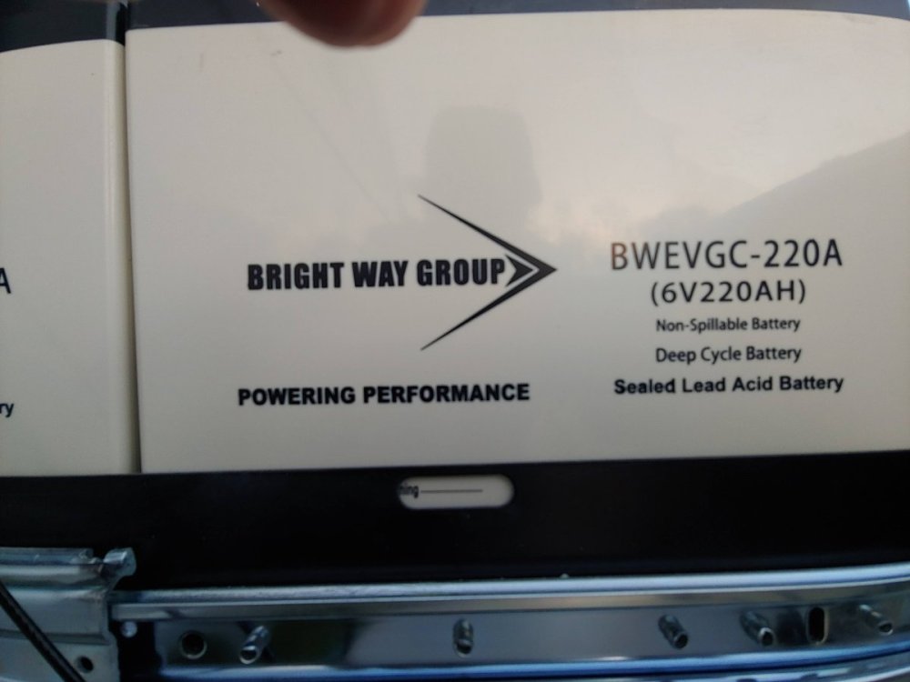

This the belated  photo Seadog asked for in my similar thread. Oliver told me mine are sealed batteries. Build sheet from original owner did not show AGM.

The battery part number is hidden under the strap.  The part number of yours and the part number of Johnwen’s battery might solve the mystery.

Based on that Bright Way part number, those are AGM type sealed lead acid batteries.

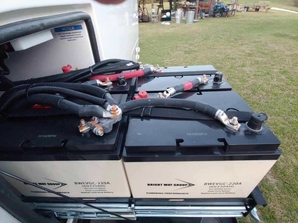

@Seadawg is correct.  My 2020 trailer came with 2 standard lead acid deep cycle batteries, no extra cost.   I also  had the optional solar package with controller (no longer an option).    See pics, my batteries looked just like @Ralph Mawyer, sealed.  Controller was set at Lead Acid, not AGM.    I used them for about a week, they worked well!  However, I couldn’t resist the urge for more power, sold them on Facebook Marketplace, and replaced with 2 BattleBorn Lithium.
