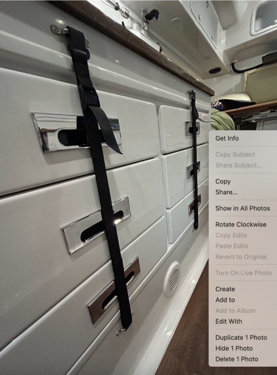

MAX Burner Posted January 28, 2024 Posted January 28, 2024 (edited) 1 hour ago, dewdev said: The newer Oliver TT have a method to lock the drawers by pushing them in tight to the cabinet. . Must be some type of locking mechanism. Can these locking devices be added to the older trailer drawers? Our 2017 wasn't configured with the positive locking drawer hardware - so we stole JDDavies' suggestion for adding drawer straps. I had taken a couple high-G turns on one of our first trips and launched the right side middle drawer (with a heavy Dutch Oven inside) into the passageway. The "JD Fix" with Footman Loops solved the problem: Edited January 28, 2024 by MAX Burner removed data Art, Diane, Magnus & Oscar (double-Aaarrf!) (SOLD) 2022 TUNDRA (SOLD) 2017 LE II; Hull #226 "Casablanca" HAM call-sign: W0ABX
