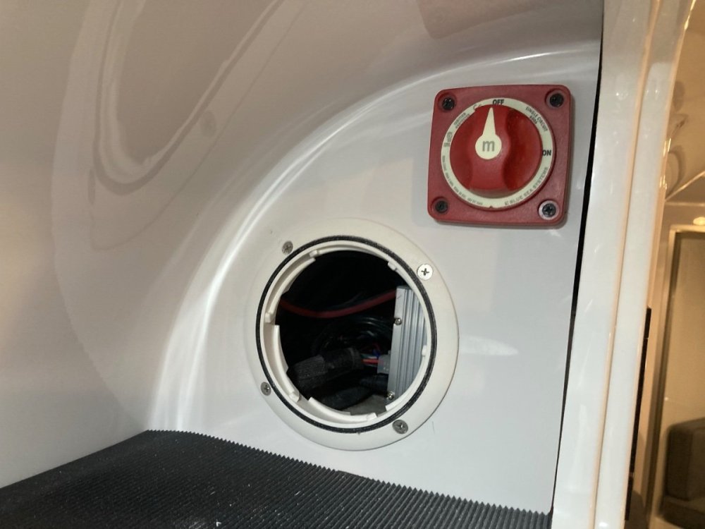

Hokieman Posted April 24, 2022 Posted April 24, 2022 3 hours ago, Degmom said: how do we turn off the solar? Do you have a red battery disconnect switch in the upper cabinet above street side bunk? That’s the solar cutoff. See pic of the one in my 2021. Not sure if 2020 had that or not. If you don’t have that switch, see pic of 2019 solar electrical diagram. You should disconnect at the batteries. Caution, the circuit will be energized if the solar panels are exposed to light. This could lead to accidental short circuit and fire. You can turn the solar panel current “off” by removing the two blade fuses on the roof, or putting tarps over the panels. See topgun2 post from April 6 above . Depending on the answers to his questions, disconnecting the batteries for just a few months might not be necessary. 2 “Ramble” - 2021 Legacy Elite II #797; 2020 Ford F-250. Former owner of 2019 Oliver Legacy Elite #431. Blairsville, GA

Hokieman Posted April 24, 2022 Posted April 24, 2022 3 minutes ago, Cameron said: The solar panel is always receiving sunshine, but not converting it because the batteries are off. Cameron….Does your Elite II have that red BlueSeas solar cutoff switch? “Ramble” - 2021 Legacy Elite II #797; 2020 Ford F-250. Former owner of 2019 Oliver Legacy Elite #431. Blairsville, GA
Cameron Posted April 24, 2022 Posted April 24, 2022 Excellent question. Don't know. If it's there, I've never used it. 2021 Elite II #841, 2020 GMC Sierra 1500 AT4, 3.0 diesel
Hokieman Posted April 24, 2022 Posted April 24, 2022 2 hours ago, Cameron said: Excellent question. Don't know. If it's there, I've never used it. I assume OTT installing them on all solar packages now. Might be useful if you ever have to disconnect batteries. The solar circuit can be turned off so the circuit is not energized when sun is shining. 3 “Ramble” - 2021 Legacy Elite II #797; 2020 Ford F-250. Former owner of 2019 Oliver Legacy Elite #431. Blairsville, GA
Bob and Dianne Posted April 24, 2022 Posted April 24, 2022 Well, looks like we do not have the red solar cut off and we don’t have a breaker or fuse for solar in the battery compartment, so we disconnected the positive lead on the battery and then the solar charge controller starts humming and all the lights on the charge controller light up. Will this hurt anything? Its parked in a garage with windows, so it’s not completely dark in there. We do have 4 wet cell batteries. 2020 LEII #671; 2021 GMC Sierra 2500 4x4

Hokieman Posted April 24, 2022 Posted April 24, 2022 I believe you have a potentially unsafe situation, the solar circuit is energized, even in the garage. I don’t know if the live circuit is harmful to the controller, but I would not take a chance. . There should be two blade fuses on the roof under the solar panels, one for each panel. If you pull those, you won’t have any current flow. You could also place a tarp over the panels. See screenshot below from the Zamp Controller manual. If your trailer is parked in a garage that can get to periodically, why not just leave the batteries connected? You will still have some small parasitic draw. Flip the AC charger breaker on occasionally and charge the batteries, then turn off. 3 “Ramble” - 2021 Legacy Elite II #797; 2020 Ford F-250. Former owner of 2019 Oliver Legacy Elite #431. Blairsville, GA
Moderators topgun2 Posted April 24, 2022 Moderators Posted April 24, 2022 3 hours ago, Mike D. said: The solar circuit can be turned off so wires are not hot when sun is shining. By using the word "hot" in this context it means that the wires have current flowing through them. 1 hour ago, Rivernerd said: There should be very little power generated by solar panels receiving no direct sunlight. Yes, you are correct - but - there STILL could be current flowing through them. In the event that the leads to the batteries are possibly handled incorrectly then they could cause a shock or could cause a short that possibly could start a fire. 4 2023 Ford F150 Lariat 3.5EB FX4 Max Towing, Max Payload, 2016 Oliver Elite II - Hull #117 "Twist" Near Asheville, NC
Moderators topgun2 Posted April 24, 2022 Moderators Posted April 24, 2022 That "red" switch that Mike D pictures above just may not be in that same location. For a long time this switch was placed under the street side bed. Look around - if you see that switch it is your ticket to happiness.🙂 Bill 3 2023 Ford F150 Lariat 3.5EB FX4 Max Towing, Max Payload, 2016 Oliver Elite II - Hull #117 "Twist" Near Asheville, NC

thompsonkd Posted April 29, 2022 Posted April 29, 2022 Can someone who has the blue sea switch, as seen in the above post, please tell me what model number the switch is? I need to put in a solar cut-off switch. Thanks. David #366 Kim and David Thompson Nomads' Nest 2018 LE2 #366 2018 Toyota Tundra, 4x4, 5.7L
Hokieman Posted April 29, 2022 Posted April 29, 2022 Blue Seas Single Circuit 6006. Click on higher resolution pic if you’d like to confirm. Note this switch disconnects the positive circuit between the panels and the controller. Zamp Tech Service told me they do not recommend a switch between their Zamp controller and batteries. 1 1 “Ramble” - 2021 Legacy Elite II #797; 2020 Ford F-250. Former owner of 2019 Oliver Legacy Elite #431. Blairsville, GA

carnivore Posted May 7, 2022 Posted May 7, 2022 On a YouTube video by Nate Yarbarough in his series The Explorist Life, he mentions an electrical code that says when installing a switch between solar panels and a charge controller, the switch used must simultaneously disconnect both the positive and negative wires. I'm looking into installing solar and lithium on my trailer and am working through the details. Anyone have any input, knowledge or discussion of any potential problems with installing a Blue Sea switch on only the positive wire between the solar panels and the charge controller?
