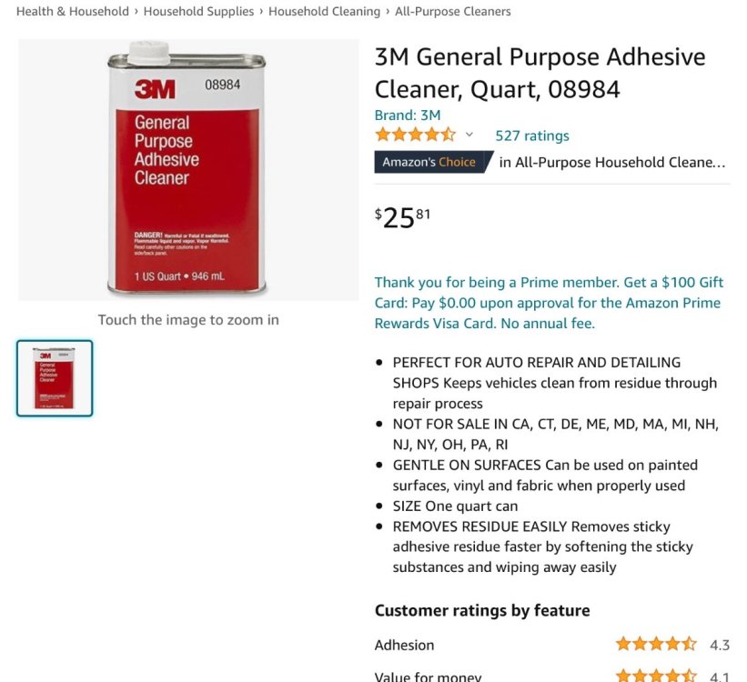

Colin Rafferty Posted April 12, 2022 Posted April 12, 2022 Bill, I think I may know what you're talking about. I recently detailed an Oliver that had little tiny black spots all around the outside. Most of the spots were on the front, next to the wheels, and on the roof. I do believe this is Tar. I tried several different things to get them off such as buffing, clay barring, and even scrubbing. The best solution for was to use a degreaser and a plastic razor blade. with three guys this too us about 2 hours to get all the black spots off the trailer.
Colin Rafferty Posted April 12, 2022 Posted April 12, 2022 On 4/11/2022 at 9:29 AM, Bill Reed said: My recently acquired second-hand trailer came to us covered in small black spots about the size of a pin head. I thought they must be bug spots but an internet search says they are mold spores. I haven't found any way to remove them except for extensive scrubbing with a non-abrasive pad, which would be way too much work for the whole trailer. Has anyone else had this problem, and how have you dealt with it? I'm thinking of using a power buffer/polisher but am worried that I might damage the gel coat. I'd be glad for any advice about how to care for the exterior of our new trailer. Bill, I think I may know what you're talking about. I recently detailed an Oliver that had little tiny black spots all around the outside. Most of the spots were on the front, next to the wheels, and on the roof. I do believe this is Tar. I tried several different things to get them off such as buffing, clay barring, and even scrubbing. The best solution for was to use a degreaser and a plastic razor blade. with three guys this too us about 2 hours to get all the black spots off the trailer.

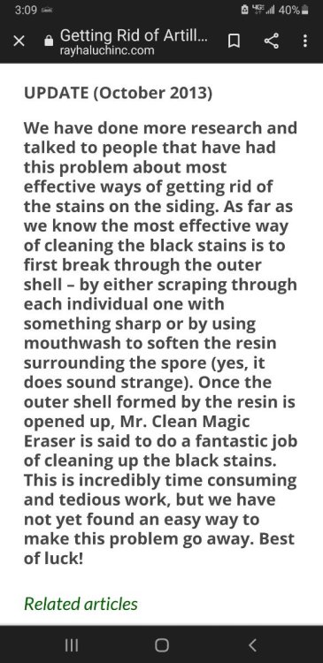

Bill Reed Posted April 12, 2022 Author Posted April 12, 2022 18 hours ago, Ron and Phyllis said: BILL REED I AM NOT THAT FAR FROM YOU (GREENEVILLE TN "THE SOUTH"), BEFORE YOU DO ANYTHING THAT THESE KNOWLEDGABLE WELL MEANING FOLKS RECOMMEND, YOU NEED TO LOOK AT THIS AND DO MORE SPECIFIC SEARCHING IF YOU HAVE NOT DONE SO. Having been faced with these tiny black spots first over 40 years ago and 20 years later around a log home, office building, and new home that I mulched around heavily, I suspect instead of mold spores, that these are from Artillary Fungus, but yes are spores. A common culprit is from wood mulch. The fungi shoot their sports toward "shiny" objects like light colored cars, white guttering and siding when the sun shines on them. It is brown or black and tarlike. Look up this fungus and see ways to remove, but my experience was that it usually leaves a lighter, less noticable, but still a spot remains underneath when you dissolve the tar spot. Lots of this info on a search. This doesn't help your specific problem, but in my case, it all stopped when I switched from wood to leaf mulch. I did find some simple, but not easy ways to remove the tar spots, but the longer they're on, the more permanent the spot damage underneath. I found no other way than to work in small segments. You can improve the appearance overall that's acceptable from a "normal" distance. If you find, a more recent, widespread easier and more effective cure, I would love to hear it, as my research is dated. Pardon if you've already discovered this. Ron I think this is exactly the problem that I am facing. But one side of my trailer is covered with literally thousands of these little black spots, so working on each one individually would take way too much time. This is a two-year-old trailer, but I have only had it a few weeks. So I don't really know how long the spots have been on it, but I am thinking at least a year. Most of them are no longer soft and easily removed with a fingernail. They are hard and tightly adhered. They are not tar, because I have tried a variety of solvents and nothing removes or even softens them. Degreasers, soaps, and other cleaning agents don't touch them either. So far the only thing that removes them is a lot of rubbing with Meguiar's 91 compound, which is way too much work if done by hand. I'm thinking I have no choice but to resort to a power buffer, but I'm still worried that I will damage the finish on the trailer. I will say that rubbing with the 91 compound by hand leaves a nice, shiny finish and doesn't seem to damage the surface at all, so perhaps my fears are unfounded. I'm grateful for all the advice. As a new Oliver owner it is wonderful to find so much help available on this forum.
Moderators SeaDawg Posted April 12, 2022 Moderators Posted April 12, 2022 If these are artillery spores, which I'd frankly never heard of til your thread, you're in for a lot of work. And, I'm sorry. I've looked at literally a dozen websites, and all of them note that they're really tough to remove, especially if they've been allowed to remain a long time. A few more home remedies to soften or remove the casings mentioned are cheap mouthwash (especially mint), murphys oil soap, Mr clean sponges, cooking oil, or dollar store awesome cleaner. (I think awesome is a bit aggressive, especially if not reduced.) Some people found success with borax, or tsp, solution in hot water, which may actually kill the tiny spores left behind in the pores. (Caustic solutions. ) general conclusion is bleach solutions only remove stain, and don't kill the spores. I'd try any (maybe all) of the methods first, before I buffed out the whole trailer. 1 2008 Ram 1500 4 × 4 2008 Oliver Elite, Hull #12 Florida and Western North Carolina, or wherever the truck goes.... 400 watts solar. DC compressor fridge. No inverter. 2 x 105 ah agm batteries . Life is good.
Moderators SeaDawg Posted April 12, 2022 Moderators Posted April 12, 2022 A few threads I've read: https://rayhaluchinc.com/getting-rid-of-artillery-fungus/ https://www.practical-sailor.com/blog/homemade-mildew-preventers-that-really-work https://www.practical-sailor.com/boat-maintenance/mildew-treatments-and-stain-removers https://www.cruisersforum.com/forums/f55/black-spots-all-over-boat-in-marina-do-i-have-any-recourse-how-to-clean-207745-3.html https://www.thehulltruth.com/northeast/97554-artillery-fungus.html https://continuouswave.com/ubb/Forum3/HTML/014222.html https://www.fiberglassrv.com/forums/f51/artillery-fungus-spots-48728.html Note: my trusted source, practical sailor, revealed no specific instructions for artillery fungus. Unfortunately. 1 2008 Ram 1500 4 × 4 2008 Oliver Elite, Hull #12 Florida and Western North Carolina, or wherever the truck goes.... 400 watts solar. DC compressor fridge. No inverter. 2 x 105 ah agm batteries . Life is good.
Moderators topgun2 Posted April 12, 2022 Moderators Posted April 12, 2022 Thanks Bill and Seadawg for getting a name that I can now publicly call these things. The language that I've historically used is not really suitable for mixed company!😇 Given the distance that my Oliver is parked away from the mulch beds I can attest to the fact that these little buggers are packing some pretty powerful ammo! Bill 1 2023 Ford F150 Lariat 3.5EB FX4 Max Towing, Max Payload, 2016 Oliver Elite II - Hull #117 "Twist" Near Asheville, NC
Moderators SeaDawg Posted April 13, 2022 Moderators Posted April 13, 2022 What I've read, so far, is they can "shoot" the spores and clinging tar up to 20 ft or more. Yikes. Hence, the artillery name. Good to note,, for everyone. Our trailer is parked on turf blocks and shell. Any mulch in our yard is cypress, and some distance from the trailer. This is super sad. Several posters in articles I read said to work away from home or away from mulch beds. This looks like a major pita. Not common here in sw Florida, probably because heat and sun kills the fungus that generates the spore pellets. Like I said, I have no prior knowledge or experience with this issue. Common mildew is easy , relatively, to remove. This crap can live on in the pores,,from what I've read, and bloom again. One guy said it lives on even old wax. Yikes. 2008 Ram 1500 4 × 4 2008 Oliver Elite, Hull #12 Florida and Western North Carolina, or wherever the truck goes.... 400 watts solar. DC compressor fridge. No inverter. 2 x 105 ah agm batteries . Life is good.
