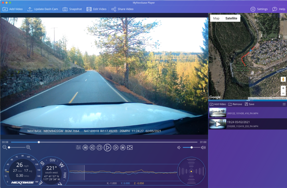

You need enough image quality to read license plates at NIGHT, and a polarizing filter to cut glare in sunlight. Everything else, like rear view cams, are optional features. I really like how this cam captures all the speed, location and G force info, and can overlay it onto a Google map. This is a screen cap of a video using their desktop application.
1973910636_ScreenShot2021-02-06at1_54_01PM.thumb.png.522e1af062a2be7f56be5b403fe8e87a.png

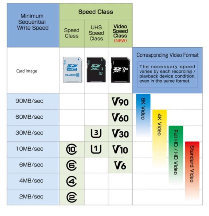

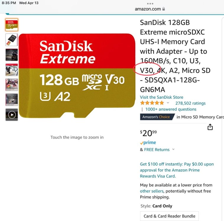

It is really important that you use a very fast memory suitable for HD video, or the camera will freeze and crash. This is what I have, the Class 10 V30 (or higher) symbol is what you look for. It depends some on if you have a 1080p cam or a 4k cam…..
