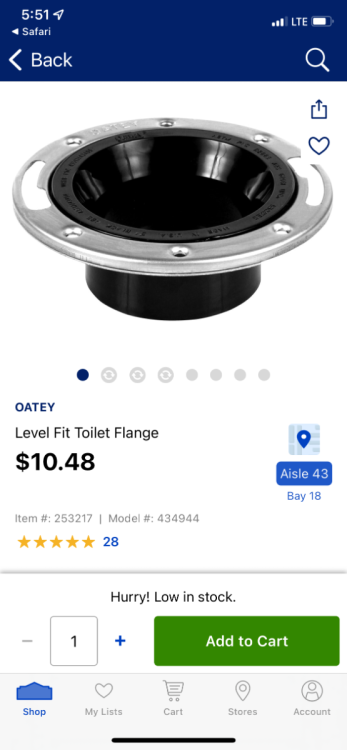

Removed the toilet and the first photo shows what the original all plastic flange looked like, cracked and broken in multiple places, including the countersunk screw holes in the plastic flange.  Might have been over-stressed when initially built.
I removed the old flange and replaced it completely with an upgraded flange with a metal mounting ring, shown in the second photo.  Had to drill new mounting holes in the floor, and because of the limited distance between the floor level and the grommet on the top of the black tank, it took some cutting of the flange collar on the underside of the flange to shorten it up a bit, and then solvent welding to adapt to a short piece of 3” PVC pipe that gets forced into the rubber grommet on the top of the black tank.  The purple streaks are a bit of dried residue from the primer used on the PVC for solvent welding.  Hidden by the toilet once it’s back in place.
This fix took care of the rocking toilet and also the small leak that would happen only when the toilet was flushed.  Water was seeping between the toilet/seal/flange/floor because of the broken/cracked flange.  The red arrow in the first photo shows the crack in the flange collar itself.  That crack was letting water leak onto the top of the black tank and then down between the hulls, and then dripping out the forward street side weep hole scupper under the hull.  The drip only happened when the toilet was flushed.
It was good to see that the floor itself under the toilet is a very thick built up panel with fiberglass over a thick core material, so the flange screws thread directly into that very well.

  • The title was changed to Updated. It’s fixed. If the toilet’s a-rockin’…..🎶
Curious,
Was there no black replacement flange available that would make it an easier replacement job?

The size/type of black ABS plastic flange used originally by Oliver is not readily available at hardware stores, and I wanted the stronger metal mounting ring to hold the toilet bolts to keep this from happening again.  Flanges with the metal ring that I found at most hardware stores tend to be a larger collar size underneath that is dual purpose to fit either INSIDE a 4” pipe or OUTSIDE a 3” pipe.  And I corrected the photo orientation just now.  And the flanges and pipe come in either white PVC or black ABS, either is fine for drain/sewer connections like this, just don’t mix them because different solvents are used to weld each type.
And you mentioned that your toilet isn’t aligned correctly now.  The bolts that hold the toilet can be moved in the flange to allow the toilet to be aligned correctly, unless Oliver mounted the flange itself way out of alignment when they repaired yours.
