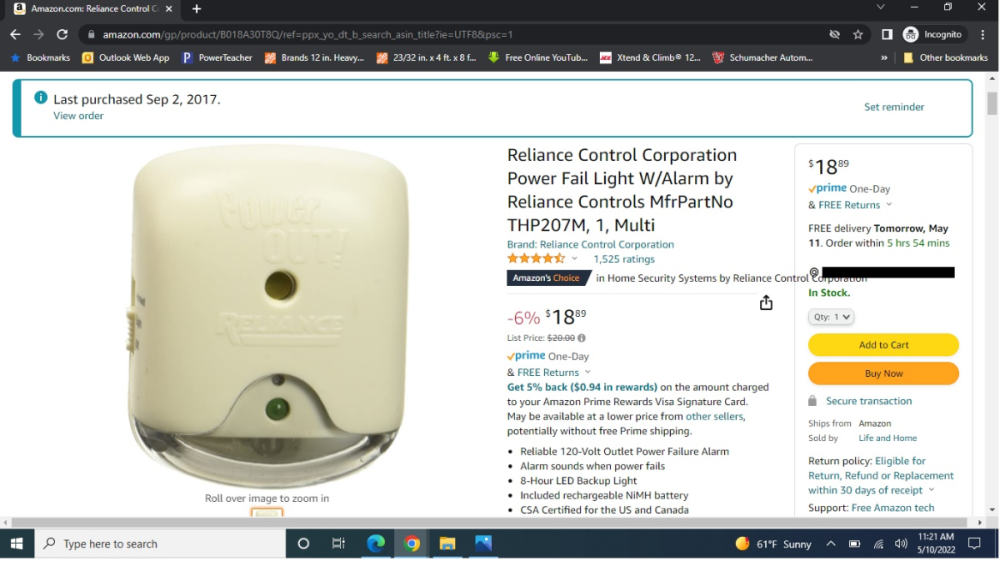

I'm sure others will find things to add. Steph and dubs alarm is great, if you camp with ac, which we rarely do. Fridge runs great on ac power, so if that's your plan, get their alarm.
