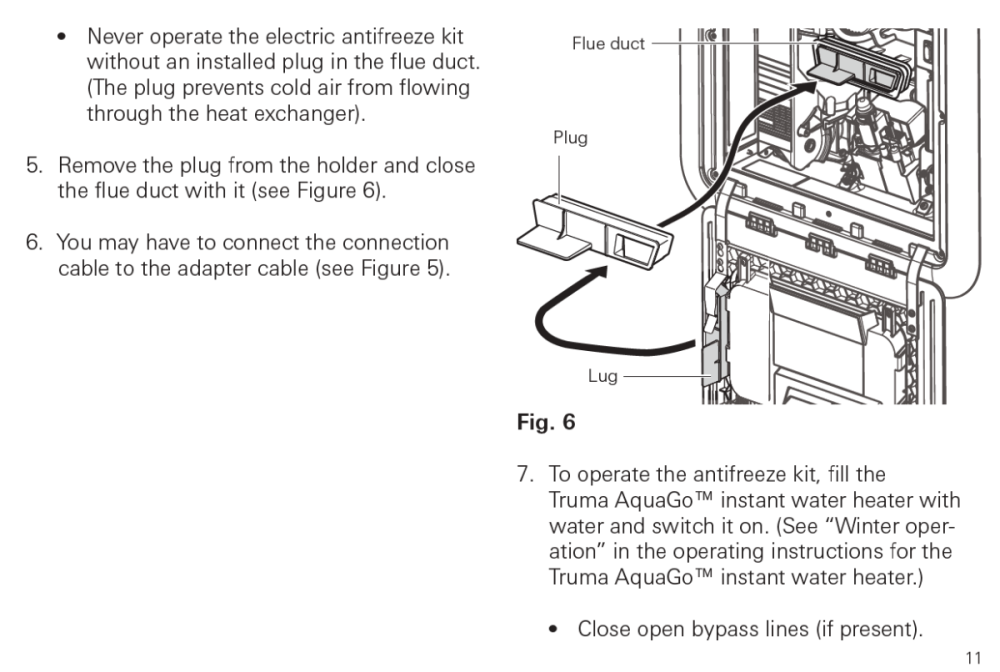

You should already have a plug clipped into a holder on the inside of the Truma door.  It looks like every Truma comes with an exhaust plug even if no electric antifreeze kit is ordered.  See picture below from the electric antifreeze instruction manual.  I used the electric antifreeze kit several times before I realized that the plug existed and was supposed to be used.  Oliver should really make a point of explaining how to install and use the antifreeze kit upon delivery.  I had to teach myself.

One other caution concerning the electric antifreeze kit that is not really explained in the manual is that the electric antifreeze module should never be energized if water has been drained from the Truma.  It would be like turning on the heating elements in a home hot water heater that was emptied of water.  The heating element would overheat and fail.  There is no need to remove the electric antifreeze module when draining the Truma, but to be safe, one should probably unplug the 12 volt wires into the antifreeze unit when winterizing, so it cannot be accidentally energized after the Truma has been drained.
