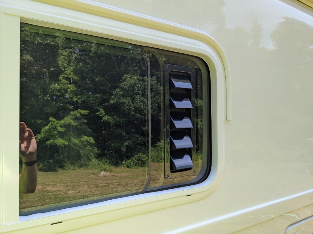

Steph and Dud B Posted July 18, 2022 Share Posted July 18, 2022 (edited) I took a page from @csevel and copied her window vent idea. I did add a couple of small twists. I used a thicker/softer automotive weatherstrip where the window meets the vent. I also put some of that weatherstrip across the top so the vent panel kind of springs in like the screens do (press upward to install/remove). Note: you do have to release the bottom edge of the window shade to get the vent into place. Then I added some EZ gutter over the window, leaving a 1/4" gap around the frame for future recaulking. Hoping this will allow us to leave that window open in light to moderate rain now. On the downside, we've had another warranty issue. The RV Lock electronic lock failed. Examination revealed that the lock was improperly installed in the door cutout. The installer simply let it rest in the bottom of the cutout instead of centering it vertically before drilling the holes in the jamb edge (or the cutout hole is too big). This left a tiny gap at the top edge of the exterior lock body where water intruded, causing the lock electronics to fail. OTT is sending another lock, but the jamb screw holes are already drilled too low so I'll have to install the new lock in the same spot and run a bead of clear sealant over the top edge of it to keep water out in the future. 😕 Still waiting for our replacement toilet flange, too. OTT shipped the parts via ground rather than overnight or 2-day. Somewhat miffed at that since we can't camp until I fix the toilet. Between the Dexter axle recall (not OTT's fault), the toilet, and the lock, we're losing a lot of our camping season. And, camping time has suddenly become very precious to us. Edited July 18, 2022 by Steph and Dud B 6 Stephanie and Dudley from CT. 2022 LE2, Hull #1150: Eggcelsior. Tow vehicle: 2016 GMC Sierra 6.0 gas dually 4x4. Our Oliver journey: Steph and Dud B's RV Screed Where we've been RVing since 1999: Link to comment Share on other sites More sharing options...

Geronimo John Posted March 23 Share Posted March 23 On 7/17/2022 at 2:39 PM, Steph and Dud B said: Then I added some EZ gutter over the window, leaving a 1/4" gap around the frame for future recaulking. Hoping this will allow us to leave that window open in light to moderate rain now. How long did it take you to install the EZ gutters? Nice job! GJ TV: 2019 F-150 SuperCrew Lariat, 3.5L EcoBoost, Max Tow, FX-4, Rear Locker OLLIE: 2018 OE2 Hull 342, Twin Bed. OLLIE DIY’s: Timken Bearings, BB LiFePO4's, Victron 712 Smart, 350 Amp Master Switch, Houghton 3400, Victron Orion DC - DC, 3000-Watt Renogy Inverter, P.D. 60-amp Converter, Frig Dual Exhaust Fans, Kitchen Drawer Straps. TV DIY’s: 2 5/16" Anderson System, Nitto recon’s, Firestone Rear Air Bags, Bilstein 5100’s, Mud Flaps & Weather Tech all, installed Ham Radio (WH6JPR). Link to comment Share on other sites More sharing options...
Steph and Dud B Posted March 23 Author Share Posted March 23 54 minutes ago, Geronimo John said: On 7/17/2022 at 8:39 PM, Steph and Dud B said: Then I added some EZ gutter over the window, leaving a 1/4" gap around the frame for future recaulking. Hoping this will allow us to leave that window open in light to moderate rain now. How long did it take you to install the EZ gutters? I just did the one window. Probably 30 minutes. 1 Stephanie and Dudley from CT. 2022 LE2, Hull #1150: Eggcelsior. Tow vehicle: 2016 GMC Sierra 6.0 gas dually 4x4. Our Oliver journey: Steph and Dud B's RV Screed Where we've been RVing since 1999: Link to comment Share on other sites More sharing options...
Moderators Mike and Carol Posted March 23 Moderators Share Posted March 23 3 hours ago, Geronimo John said: How long did it take you to install the EZ gutters? Nice job! GJ I’ve done it twice. It took the better part of an afternoon to do all the windows. Mike 4 Texas Hill Country | 2016 Elite II #135 | 2020 Ram 2500 6.7L Link to comment Share on other sites More sharing options...
Moderators SeaDawg Posted March 24 Moderators Share Posted March 24 2 hours ago, Mike and Carol said: I’ve done it twice. It took the better part of an afternoon to do all the windows. Mike I think it took us about three hours, to do all the windows, back over a decade ago. Fastest on a warm day. We've replaced a couple over the years. 20 minutes for one. Well worth the time. 3 2008 Ram 1500 4 × 4 2008 Oliver Elite, Hull #12 Florida and Western North Carolina, or wherever the truck goes.... 400 watts solar. DC compressor fridge. No inverter. 2 x 105 ah agm batteries . Life is good. Link to comment Share on other sites More sharing options...
Moderators topgun2 Posted March 24 Moderators Share Posted March 24 (edited) The key to the install of this stuff is to clean, clean, clean prior to even thinking about applying the gutter material. Bill p.s. and a nice warm day doesn't hurt either - 80 degrees plus Edited March 24 by topgun2 added detail 5 2023 Ford F150 Lariat 3.5EB FX4 Max Towing, Max Payload, 2016 Oliver Elite II - Hull #117 "Twist" Near Asheville, NC Link to comment Share on other sites More sharing options...
Geronimo John Posted March 26 Share Posted March 26 Thank you ALL! With the Houghton up top, it makes the EZ gutter Mod even more relivant. GJ 1 TV: 2019 F-150 SuperCrew Lariat, 3.5L EcoBoost, Max Tow, FX-4, Rear Locker OLLIE: 2018 OE2 Hull 342, Twin Bed. OLLIE DIY’s: Timken Bearings, BB LiFePO4's, Victron 712 Smart, 350 Amp Master Switch, Houghton 3400, Victron Orion DC - DC, 3000-Watt Renogy Inverter, P.D. 60-amp Converter, Frig Dual Exhaust Fans, Kitchen Drawer Straps. TV DIY’s: 2 5/16" Anderson System, Nitto recon’s, Firestone Rear Air Bags, Bilstein 5100’s, Mud Flaps & Weather Tech all, installed Ham Radio (WH6JPR). Link to comment Share on other sites More sharing options...
