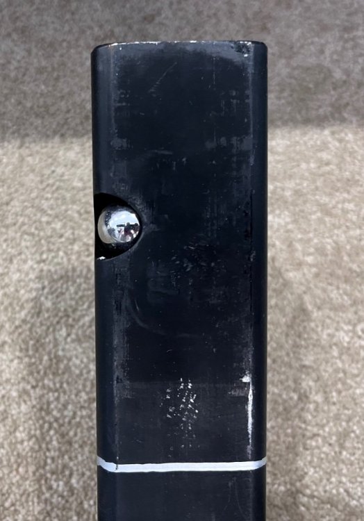

FYI, this is important, the 1-Up and some other expensive racks like that Yakima Stage 2 have a proprietary locking mechanism to stop play (rocker stopper).  The 1-Up rack is made primarily of aluminum, yay, but it uses a steel stinger which has a great big stainless steel ball that cams out and locks to the inside of the female receiver. It is extremely effective! BUT you need a steel receiver, because it will literally destroy an aluminum one, plus there would obviously be dissimilar metal corrosion worries.
That rack is used with my Land Cruiser, I don’t have a square receiver my Ollie. I mentioned this part in a different thread, but I will do again here. I would simply bolt on this unit to the top of the factory cross bar, with an insulating pad between the two parts. It would probably be cheaper than having a shop fabricate one from raw steel. And this has a pretty powder coating, the shop would just spray it with some rattle can enamel without bothering to prime it. So you would end up redoing it yourself in a year.  😀

FYI, this is important, the 1-Up and some other expensive racks like that Yakima Stage 2 have a proprietary locking mechanism to stop play (rocker stopper).  The 1-Up rack is made of primarily of aluminum, yay, but it uses a steel stinger which has a great big stainless steel ball that cams out and locks to the inside of the female receiver. It is extremely effective! BUT you need a steel receiver, because it will literally destroy an aluminum one, plus there would obviously be dissimilar metal corrosion worries.
I mentioned this part in a different thread, but I will do again here. I would simply bolt on this unit to the factory cross bar, with an insulating pad underneath it. It would probably be cheaper than having a shop fabricate one from raw steel. And this has a pretty powder coating, the shop would just spray it with some ratlle can enamel without bothering to prime it. So you would end up redoing it yourself in a year.  😀
Ultra-Tow Step Bumper Receiver - Class II, 3500-Lb. GTW, 2in.
Great! That makes the most sense to me. The rocker stopper seems like a key structural component. So, unbolt Oliver’s wee 1.25” receiver, drill 4 new holes through Oliver’s Al crossbar, place a thin sheet of neoprene to form a gasket between the steel Ultra-tow 2” receiver above and Oliver’s Al crossbar to prevent Fe-Al corrosion, secure the Ultra-tow 2” receiver using SS through bolts, order a 1UP 2” Heavy Duty Double and, budda bing, I’m good to go. I suppose I should use bolts that are a slightly smaller diameter than the hole diameter to limit Al-Fe contact, or put a plastic sleeve in the hole, or wrap the bolts in neoprene tape, and use a rubber washer between the SS washer/bolt and Al crossbar.

I don’t recommend the Heavy Duty rack, I am not sure it is even RV rated. You need a Super Duty.
I think you need a really stiff material as insulator pad, so it does’t flex at all. Oliver uses some rubber like sheet between the support arms and the top of the sewer compartment, and they say that they haven’t seen loose bolts, but to be safe I would find a plastic sheet that won’t try to squeeze out..
The stainless hardware is fine but adding rubber washers and sleeves in addition is overkill unless you plan to tow through battery acid. Oliver doesn’t use that with their hardware. Though they do add aluminum sleeves in one place, where the Bulldog coopler bolts go through the tongue.

I use the Yakima Stage Two, but with a 2" receiver that I got from Curt Hitches.  I just removed the 1.25" from OTT and drilled new holes to attach the Curt hitch.  I did use high tension stainless steel bolts and nuts to hedge my bets.  When I was in Hohenwald in November, 2023, I had them do the electrical hook up as I got the optional light bar/license plate holder for the bike rack.
