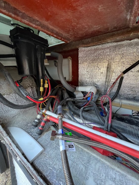

CRM Posted October 25, 2022 Share Posted October 25, 2022 Since I purchased my Ollie about a year ago, I've had an odd odor that seemed to come and go even though she's always spotless inside and I run a large home sized dehumidifier set below 50%. Well, today I found the source... wet plywood sandwiched between sheets of fiberglass installed in the basement floor. I was under the impression that no plywood was used in construction so I was a little surprised to find this. I'm now wondering if this something from the factory, or if one of the prior owners modified the basement floor? In the end, no big deal since it's not structural, and I wanted to install new vinyl sheet flooring in the basement anyway. Will probably just lay in a 1/2 sheet of PVC now prior to the vinyl. 3 2010 Elite II, Hull #45. 2014 Toyota Sequoia Platinum 4WD 5.7 with tow package. Link to comment Share on other sites More sharing options...
Moderators topgun2 Posted October 25, 2022 Moderators Share Posted October 25, 2022 My money would be on a modification by a prior owner. The insulation is also interesting. Bill 2 2023 Ford F150 Lariat 3.5EB FX4 Max Towing, Max Payload, 2016 Oliver Elite II - Hull #117 "Twist" Near Asheville, NC Link to comment Share on other sites More sharing options...
CRM Posted October 25, 2022 Author Share Posted October 25, 2022 36 minutes ago, topgun2 said: The insulation is also interesting. Bill Pretty sure that the insulation is original as it goes under the tanks. Looks like fiberglass in the pic but I'm fairly certain that it isn't. Looks and feels more like wool. Edit- It also has the lizard skin spray-on insulation which seems to be everywhere else other than the basement. Plan on adding some Reflectix once I'm finished with the flooring. 1 1 2010 Elite II, Hull #45. 2014 Toyota Sequoia Platinum 4WD 5.7 with tow package. Link to comment Share on other sites More sharing options...
bhncb Posted October 25, 2022 Share Posted October 25, 2022 I suspect the initial model years were pretty much one-offs, as construction materials and techniques evolved. That massive aluminum framework in the picture is certainly impressive. Oliver likely used encapsulated plywood for the basement floor because of its superior strength. Ultimately, the virtues of expand PVC became too hard to ignore. What a great clean-slate-start to a uniquely personal LEII this one can be. 1 2 Link to comment Share on other sites More sharing options...

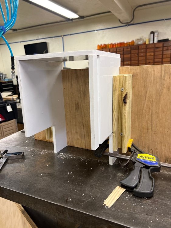

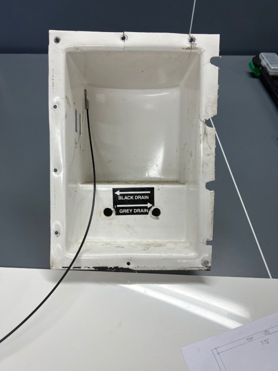

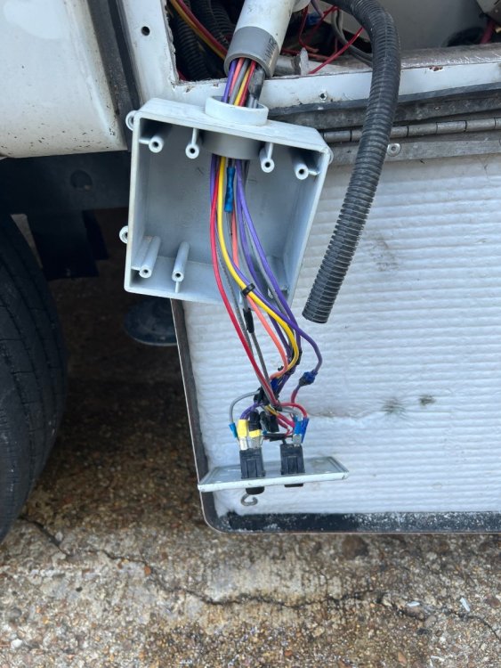

CRM Posted October 26, 2022 Author Share Posted October 26, 2022 6 hours ago, ScubaRx said: This is involving construction of a new outdoor faucet and tank valve box as all the early trailers had a vacuum formed box made of really thin plastic. Mine was broken all to pieces and looked horrible. Also, I plan to reroute the plumbing away from that cold susceptible area right next to the outer hull to a more inboard position where it will be subjected to more between the hulls heating. My plan is also place electric valves in those lines so they can be isolated from the rest of the plumbing and drained if necessary. There will be some effort made to relocate some of the electrical wires in that area. I guess I should take a closer look at my faucet and tank valve box.. Didn't notice any cracking, but it's definitely the same one as yours and it might be better to change it out now and not have to get back into this a year or two down the road. I will also be putting in valves to isolate the plumbing but will be using manual valves since I hope to never camp in freezing temps anyway. 1 2010 Elite II, Hull #45. 2014 Toyota Sequoia Platinum 4WD 5.7 with tow package. Link to comment Share on other sites More sharing options...
Moderator+ ScubaRx Posted October 27, 2022 Moderator+ Share Posted October 27, 2022 Out with the old, in with new… I am about to glue the outside flanges on, and the outside shower box should be completed. I purposely made it a bit larger on the inside and the back is square as opposed to rounded on the original. 1 4 Steve, Tali and our dog Rocky plus our beloved Storm, Maggie, Lucy and Reacher (all waiting at the Rainbow Bridge) 2008 Legacy Elite I - Outlaw Oliver, Hull #026 | 2014 Legacy Elite II - Outlaw Oliver, Hull #050 | 2022 Silverado High Country 3500HD SRW Diesel 4x4 Link to comment Share on other sites More sharing options...
CRM Posted October 27, 2022 Author Share Posted October 27, 2022 7 minutes ago, ScubaRx said: Out with the old, in with new… I am about to glue the outside flanges on, and the outside shower box should be completed. I purposely made it a bit larger on the inside and the back is square as opposed to rounded on the original. Nice work ! 1 2010 Elite II, Hull #45. 2014 Toyota Sequoia Platinum 4WD 5.7 with tow package. Link to comment Share on other sites More sharing options...

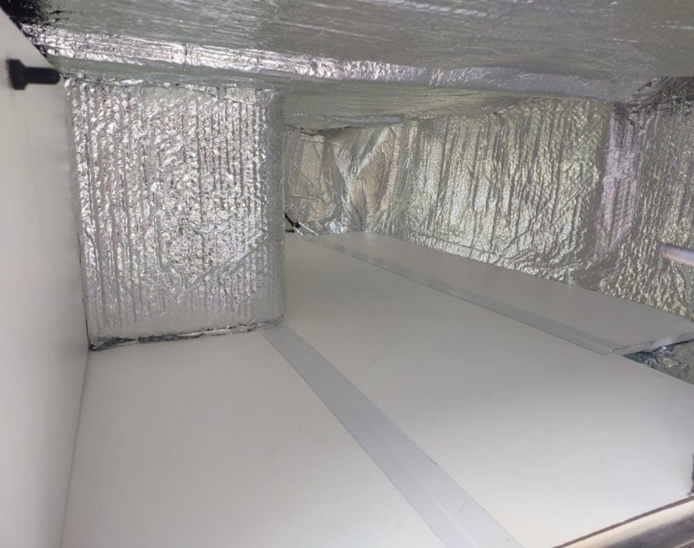

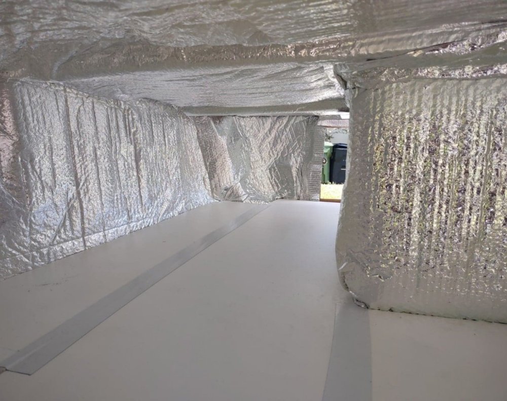

CRM Posted November 4, 2022 Author Share Posted November 4, 2022 New PVC floor in and basement insulated with Reflectex. Still have to copy what @ScubaRx has done and build a new shower box but that will have to wait until after our thanksgiving trip down in the Keys. Will be installing a rubber mat over the floor too to keep things from sliding around. 4 2010 Elite II, Hull #45. 2014 Toyota Sequoia Platinum 4WD 5.7 with tow package. Link to comment Share on other sites More sharing options...
Moderator+ ScubaRx Posted November 4, 2022 Moderator+ Share Posted November 4, 2022 29 minutes ago, CRM said: New PVC floor in and basement insulated with Reflectex. Still have to copy what @ScubaRx has done and build a new shower box but that will have to wait until after our thanksgiving trip down in the Keys. Will be installing a rubber mat over the floor too to keep things from sliding around. Wow! That’s a great job. Still working on mine. Did you apply the the reflectex with spray adhesive? Steve, Tali and our dog Rocky plus our beloved Storm, Maggie, Lucy and Reacher (all waiting at the Rainbow Bridge) 2008 Legacy Elite I - Outlaw Oliver, Hull #026 | 2014 Legacy Elite II - Outlaw Oliver, Hull #050 | 2022 Silverado High Country 3500HD SRW Diesel 4x4 Link to comment Share on other sites More sharing options...
CRM Posted November 4, 2022 Author Share Posted November 4, 2022 4 minutes ago, ScubaRx said: Wow! That’s a great job. Still working on mine. Did you apply the the reflectex with spray adhesive? Thanks, it came out better than I thought it would and I'm now very happy to have eliminated any chance of future moisture damage.. And yes, I used 3M Super 77 spray adhesive for most of it and Velcro strips for around the lights to allow for easy access. 1 2010 Elite II, Hull #45. 2014 Toyota Sequoia Platinum 4WD 5.7 with tow package. Link to comment Share on other sites More sharing options...

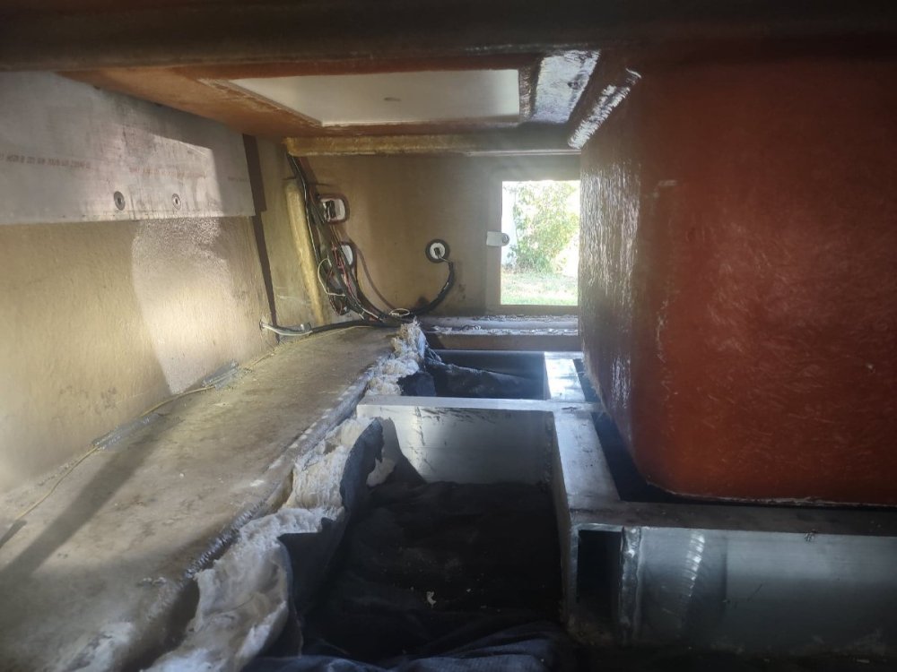

Moderator+ ScubaRx Posted November 4, 2022 Moderator+ Share Posted November 4, 2022 2 hours ago, CRM said: Thanks, it came out better than I thought it would and I'm now very happy to have eliminated any chance of future moisture damage... Well, you’re way ahead of me. This is the current state of disrepair in my basement. About to start rerouting plumbing. o 3 1 Steve, Tali and our dog Rocky plus our beloved Storm, Maggie, Lucy and Reacher (all waiting at the Rainbow Bridge) 2008 Legacy Elite I - Outlaw Oliver, Hull #026 | 2014 Legacy Elite II - Outlaw Oliver, Hull #050 | 2022 Silverado High Country 3500HD SRW Diesel 4x4 Link to comment Share on other sites More sharing options...
CRM Posted November 4, 2022 Author Share Posted November 4, 2022 46 minutes ago, ScubaRx said: Well, you’re way ahead of me. This is the current state of disrepair in my basement. About to start rerouting plumbing. Looks like you have a lot more work to do than I did. I got off easy as I didn't have any water line rerouting to contend with. After seeing pics of your basement, I'm now wondering if I should go back and install the light bezels through the Reflectix or not. 1 1 2010 Elite II, Hull #45. 2014 Toyota Sequoia Platinum 4WD 5.7 with tow package. Link to comment Share on other sites More sharing options...
CRM Posted November 11, 2022 Author Share Posted November 11, 2022 Finished off the basement floor with some leftover vinyl flooring and installed a couple of light bars... On to the next project! 1 5 1 2010 Elite II, Hull #45. 2014 Toyota Sequoia Platinum 4WD 5.7 with tow package. Link to comment Share on other sites More sharing options...
Moderator+ ScubaRx Posted November 12, 2022 Moderator+ Share Posted November 12, 2022 Vinyl flooring, well LA-DEE-DA. You are just too cool. That really looks good. as far as light bezels through the Reflectix goes, I don't think its necessary. I would, however, make sure the bezels are well caulked with clear caulk on the outside, especially at the bottom of each bezel. They did not do that on the 2007-2010 models nor the early builds starting in 2013 and customers complained of leaks in those areas. If they leaked behind Reflectix, you would not immediately know it. Just something to be aware of, hope that it's helpful. 1 2 Steve, Tali and our dog Rocky plus our beloved Storm, Maggie, Lucy and Reacher (all waiting at the Rainbow Bridge) 2008 Legacy Elite I - Outlaw Oliver, Hull #026 | 2014 Legacy Elite II - Outlaw Oliver, Hull #050 | 2022 Silverado High Country 3500HD SRW Diesel 4x4 Link to comment Share on other sites More sharing options...
