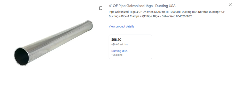

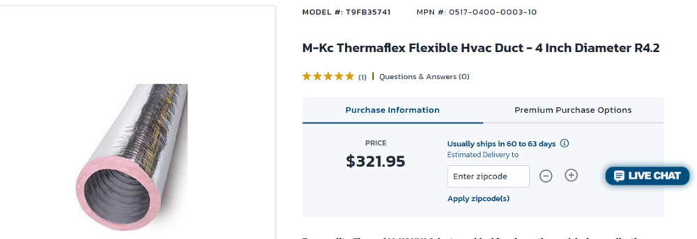

Geronimo John Posted January 2, 2023 Share Posted January 2, 2023 On 12/12/2022 at 4:21 AM, GAP said: Can you be more specific as to the type of product and why it is more efficient? Unlike the "semi rigid" duct I've added to the StreetSide, I have not noticed the rumpled duct exterior heating up DUCT TEMP: The rumpled uninsulated thin aluminum spiral air transfer duct gives up a lot of heat right at the furnace. Compare the surface temperature of it under the bathroom sink and say a foot from the furnace itself. SMOOTH BORE DUCTS: Think of it as the difference between a rifle and a shot gun. For moving air efficiently a smooth bore allows for more laminar air flow vs. the rumpled flex duct. Here are two smooth bore ducts and below a compromise duct with a smoother bore. Every product has it's pro/cons. Uninsulated or poorly insulated ducts in our hulls lose heat as they travel across the hull. This for moderate temp camping is wasted fuel. But for COLD weather camping, it is a good thing. Point is that well insulated ducting is not for everybody. For the cold weather campers, I really like Hokieman's concept of using a fan to push air from the dinette foot area into the street side basement. And as suggested using an electric heater by the fan, and air transfer holes in the various walls creating a heated air return path down the street-side, basement and back to the furnace. The concept would be easy to do, and when not needed (as suggested) just turn it off. However, my concern is actually with getting warm air movement at the rear shower area for an un-ducted air flow path. It's a long way with many air leakage opportunities and the freely moving air would likely be giving up it's heat long before it got to the most important target.... the aft shower plumbing area. To optimize Hokieman's concept: A. I suggest using a duct fan and lightly insulated 3" round duct. (Maybe DWV plastic???) Doing so would significantly improve the odds of getting warm air onto the aft shower plumbing area. By using lightly insulated duct, it allows for some heat transfer along the street-side basement to the primary target area. The duct fan needs to be very quiet. My suggestion is to get a 2" fan and run it in 3" duct. Only need say 20 to 35 CFM range. B. For the duct fan control, I would use an Off/On/Auto switch. The Auto would be tied to a normally open thermal switch located at the most cold exposed surface of the aft shower area plumbing. The switch should close when the temp in the area falls below say 30 degrees F. They cost less than $10. WHY? So for example, if your are away from the trailer and bad conditions hit, or if you just forget to switch it on, if you have left it in "AUTO", you are still "somewhat" freeze protected. (NOTE: Somewhat because i would not recommend leaving an free standing electric space heater running while you are gone.) "ON" turns on the fan and leaves it on. "OFF" is off. Hope this helps. GJ TV: 2019 F-150 SuperCrew Lariat, 3.5L EcoBoost, Max Tow, FX-4, Rear Locker OLLIE: 2018 OE2 Hull 342, Twin Bed. OLLIE DIY’s: Timken Bearings, BB LiFePO4's, Victron 712 Smart, 350 Amp Master Switch, Houghton 3400, Victron Orion DC - DC, 3000-Watt Renogy Inverter, P.D. 60-amp Converter, Frig Dual Exhaust Fans, Kitchen Drawer Straps. TV DIY’s: 2 5/16" Anderson System, Nitto recon’s, Firestone Rear Air Bags, Bilstein 5100’s, Mud Flaps & Weather Tech all, installed Ham Radio (WH6JPR). Link to comment Share on other sites More sharing options...
GAP Posted January 2, 2023 Share Posted January 2, 2023 17 minutes ago, Geronimo John said: DUCT TEMP: The rumpled uninsulated thin aluminum spiral air transfer duct gives up a lot of heat right at the furnace. Compare the surface temperature of it under the bathroom sink and say a foot from the furnace itself. SMOOTH BORE DUCTS: Think of it as the difference between a rifle and a shot gun. For moving air efficiently a smooth bore allows for more laminar air flow vs. the rumpled flex duct. Here are two smooth bore ducts and below a compromise duct with a smoother bore. Every product has it's pro/cons. Uninsulated or poorly insulated ducts in our hulls lose heat as they travel across the hull. This for moderate temp camping is wasted fuel. But for COLD weather camping, it is a good thing. Point is that well insulated ducting is not for everybody. For the cold weather campers, I really like Hokieman's concept of using a fan to push air from the dinette foot area into the street side basement. And as suggested using an electric heater by the fan, and air transfer holes in the various walls creating a heated air return path down the street-side, basement and back to the furnace. The concept would be easy to do, and when not needed (as suggested) just turn it off. However, my concern is actually with getting warm air movement at the rear shower area for an un-ducted air flow path. It's a long way with many air leakage opportunities and the freely moving air would likely be giving up it's heat long before it got to the most important target.... the aft shower plumbing area. To optimize Hokieman's concept: A. I suggest using a duct fan and lightly insulated 3" round duct. (Maybe DWV plastic???) Doing so would significantly improve the odds of getting warm air onto the aft shower plumbing area. By using lightly insulated duct, it allows for some heat transfer along the street-side basement to the primary target area. The duct fan needs to be very quiet. My suggestion is to get a 2" fan and run it in 3" duct. Only need say 20 to 35 CFM range. B. For the duct fan control, I would use an Off/On/Auto switch. The Auto would be tied to a normally open thermal switch located at the most cold exposed surface of the aft shower area plumbing. The switch should close when the temp in the area falls below say 30 degrees F. They cost less than $10. WHY? So for example, if your are away from the trailer and bad conditions hit, or if you just forget to switch it on, if you have left it in "AUTO", you are still "somewhat" freeze protected. (NOTE: Somewhat because i would not recommend leaving an free standing electric space heater running while you are gone.) "ON" turns on the fan and leaves it on. "OFF" is off. Hope this helps. GJ Lots of great stuff there Gj. I am especially interested in the insulated flexible vent duct options. I'd like to replace sections of duct close to the furnace as that is an area least in need of heating that runs super warm because of heat loss through the duct itself. I've replaced the duct line that feeds the cabin mid way under the curbside bed. Ran the new duct to a spot opposite the existing vent under the galley so now there is one close to the battery compartment. I used semi rigid duct which gets hot so it has heated the compartment surrounding the exterior shower and opened a vent through to the garage to share heat with pex lines run through there. insulated (with reflectix) areas close to electronics to protect that stuff. Will add some of your suggested insulated duct from the furnace till the duct comes out under the streetside bed as to minimize heating areas where not needed. The ideas about running a fan and portable AC powered heater sound like smart thinking but I have yet to winter camp somewhere with access to shore power so may be a project for next summer. Thanks much for sharing. Very helpful stuff. SOLD: 2021 Elite 2, Twin Bed, Lithium & Solar, 3000W Inverter SOLD: 2022 Ford F150, 3.5L V6 EcoBoost, 4x4 Supercab, Trailer Tow Package Link to comment Share on other sites More sharing options...
Geronimo John Posted January 2, 2023 Share Posted January 2, 2023 1 hour ago, GAP said: Will add some of your suggested insulated duct Do some searches on this as likely there are other similar products at a less expensive cost. I do suggest that you ensure your selection is rated for the temperature you expect it to be utilized. Good luck, GJ 1 TV: 2019 F-150 SuperCrew Lariat, 3.5L EcoBoost, Max Tow, FX-4, Rear Locker OLLIE: 2018 OE2 Hull 342, Twin Bed. OLLIE DIY’s: Timken Bearings, BB LiFePO4's, Victron 712 Smart, 350 Amp Master Switch, Houghton 3400, Victron Orion DC - DC, 3000-Watt Renogy Inverter, P.D. 60-amp Converter, Frig Dual Exhaust Fans, Kitchen Drawer Straps. TV DIY’s: 2 5/16" Anderson System, Nitto recon’s, Firestone Rear Air Bags, Bilstein 5100’s, Mud Flaps & Weather Tech all, installed Ham Radio (WH6JPR). Link to comment Share on other sites More sharing options...
