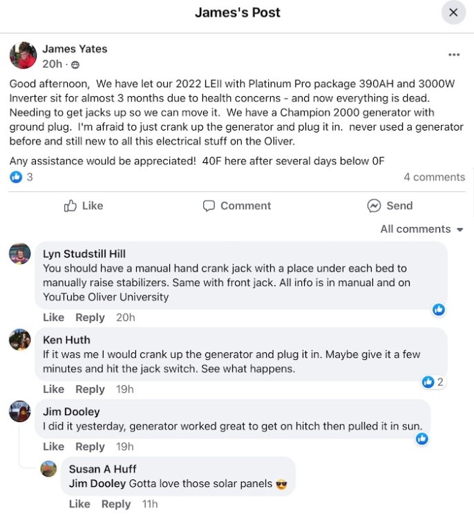

We have 2022 LEII that we parked a few months ago in storage and it has just gone through a huge cold snap.  I'm needing to move it from storage and it is totally dead.  I have the generator and ground plug but I'm afraid to just plug the cord into it.  But everything is dead so I don't think I could change any settings anyway.  It is 40f here today after below zero.  Will I hurt anything?  Should I turn batteries on if they will turn on?
Thanks for any info!!

Hello Everyone:  Goodness I do have a lot to learn about the elictrical system on this trailer.  Sorry I didn't put complete info down about the trailer.  We do have a Platinum Pro package with 3 Lithium Batteries hat equal 390 amp hours.  They do (I think) have internal heaters with blue lights that glow blue when on.  There is also an off/on switch that is connected to a red wire that runs above the batteries that I honstly don't know exactly what it goes to..  Yesterday it did not get above freezing.  Today we are above freezing.  The Lithionics app says the batteries are 81%, 81% and 83% with 12.21V, 12.2V, 12.22V and the battery temps show 33F 34F 34f.  The batteries did turn on for me just now and I have reset the Xantrix to 15 amps from 25 amps.  Xantric shows 12.2V on wall and app shows battery 25%.  So I am now going to go hook up my generator.
I'm also learning how to use this site - so thanks for the messages and I am going to read more about charging lithiums fro John also.
