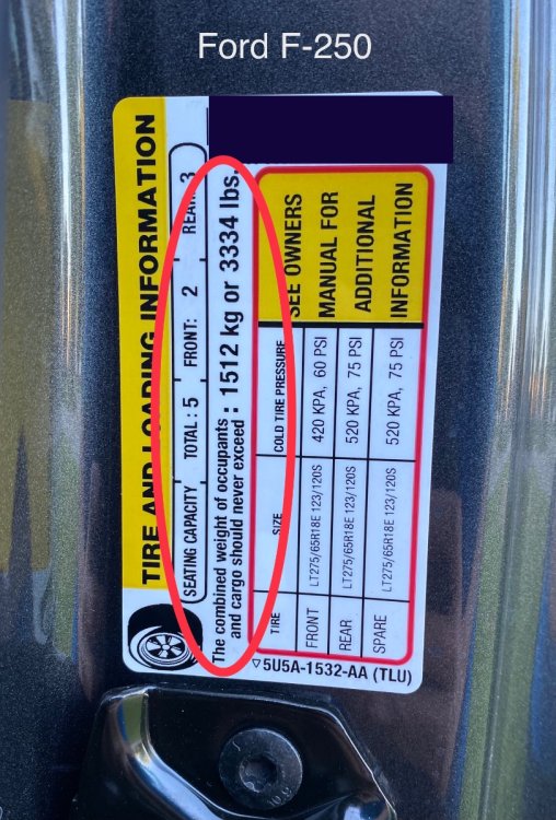

bbrault Posted March 15, 2023 Author Posted March 15, 2023 11 hours ago, Farside said: Payload is usually the limiting factor. What does it say on the sticker inside your drivers side door (it will say something like “the total of passengers and cargo should not exceed”. It says not to exceed 1390 pounds.

Frank C Posted March 15, 2023 Posted March 15, 2023 So from that 1,390 pound payload limit, subtract the Elite I tongue weight of 400 to 500 pounds, then subtract the weight of 3 adults (500 to 600 pounds), and subtract the weight of the Andersen hitch (~50 lbs.), subtract the weight of Rock Tamer mud flaps if you add those to the hitch (~50 lbs.), then subtract the weight of EVERYTHING ELSE that’s ever been added in or on your tow vehicle (floor mats, mud flaps, cargo liner, tools, etc.) and that gives you the remaining payload number left for your camping gear. It gets used up surprisingly fast when you honestly count the weight of EVERYTHING that wasn’t in or on the vehicle from the factory. We started towing our Elite II with large body-on-frame SUVs (a Ford Expedition EL with HD tow package first, and then a Nissan Armada). On paper, both were fully capable of towing the Elite II (both did require the Andersen WDH), but the reality for camping was not ideal. And the EcoBoost V6 engine in the Expedition felt overworked when towing in the mountains. We carry a lot for extended road/camping trips, and while both those SUVs had plenty of cargo/payload weight rating (around 1,700 lbs.) and towing capacity, the reality was that cargo VOLUME became a bigger issue for long camping trips. We carry two camp chairs, a 9’x12’ outdoor rug, a folding picnic table, a drying rack for clothes, a portable grill, an extra 20 lb. propane tank, tools and emergency roadside gear, two bicycles, an ice filled cooler, portable solar panel, etc. so I was getting close to the payload weight limit and also just ran out of space in those SUVs. We now use a Ford F-250 and no more worries. Towing and camping are much more enjoyable now. 5
