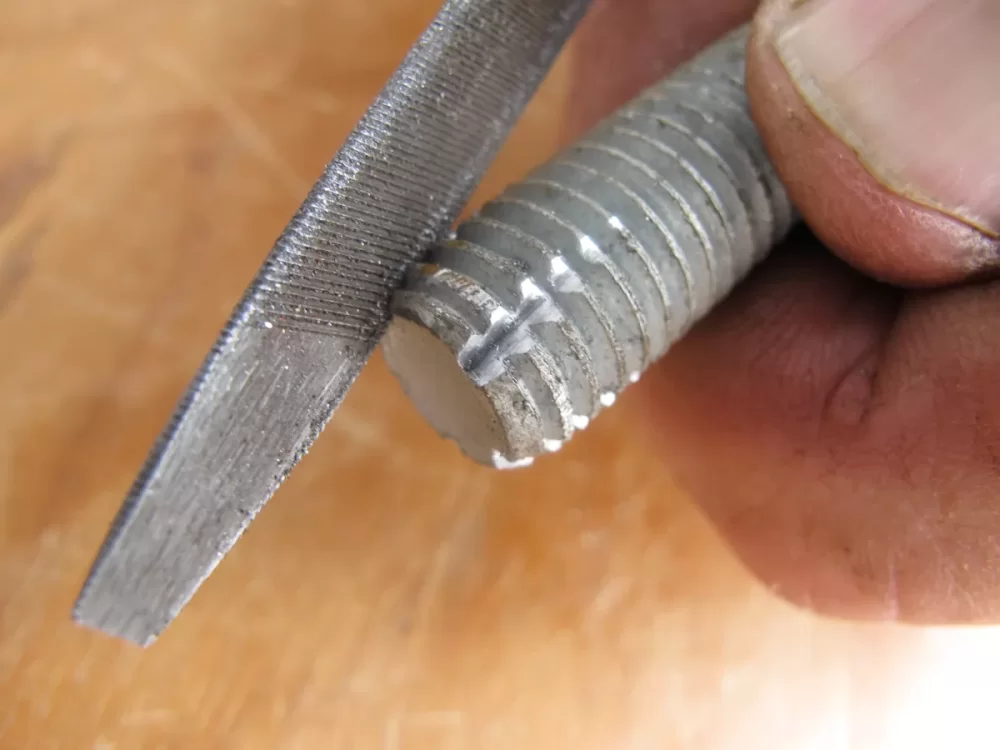

Take the old rod and cut off the nut portion. Put it in a vice and cut half a dozen deep slots at 90 degrees to the threads. Clean the part with a wire brush or wire wheel. Now you have a 3/4” MPT thread chaser. Run that in and out repeatedly until all the crusty white deposits are gone. Now you will be able to screw the replacement rod win all the way! Flush thoroughly with water or compressed air (watch your eyes). Keep it with your spares kit so you can do it routinely.
 Sort of like this pic, but a hack saw is quicker and makes much better grooves.
