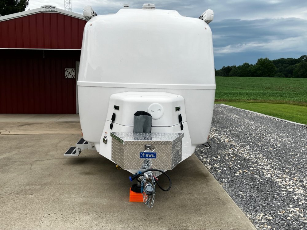

Ok, after much consideration and some mentoring from @mountainoliverĀ I finally purchased and installed a storage box for my trailer tongue. Ā It was not the least expensive option but I got an incredible deal on it through a local vendor (truck parts/accessories store). Ā These have an insulated top, one hand opening feature and are very well made.
Thank you for all the ideas and suggestions on this thread.
Brian
Looks good!

@Brian and BrandelyneĀ very nice, is that the 49ā€ UWS aluminum box, do you have a link for it?

@rich.devĀ it is 34ā€ across the back and 20ā€ in the front.Ā
Ā
I will look for a link when I get home but it’s easy to find on Amazon. As I mentioned, my local guy was able to get it for much less than Amazon.Ā
Shop around.Ā
Disregards the link, I found it, thanks!

@rich.devĀ I didn't have a factory basket so I called OTT and ordered the hardware they use to mount the baskets. It included the nice rubber strip that mounts between the basket and the fiberglass.
Ah great thanks good to know! šŸ‘šŸ»
Brian, did you have to buy any additional hardware?Ā
I mounted a piece of square aluminum tubing (1" x 3" x 12") under the front inspired by @mountainoliverĀ and then I added a strip on aluminum on the inside back for additional rigidity. I don't think I needed that as they welded nice aluminum angle brackets along the front and back. I will NOT be carrying a generator in this box, it is primarily for our camping needs.
I just have an issue putting things that are wet or dirty in the basement so close to the sleeping area although I try to clean them as much as possible before putting them in there.

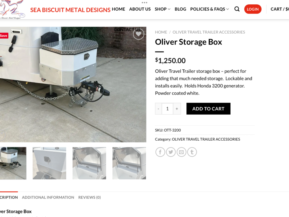

I saw this on the Oliver FB page. It’s a nice looking storage box and appears well made.Ā
Ā
https://seabiscuitmetaldesigns.com/product/oliver-box/

2 hours ago, Patriot said:
I saw this on the Oliver FB page. It’s a nice looking storage box and appears well made. Pricey.
Looks like a nice box. Ā Pretty expensive though. Ā My $150 Amazon aluminum box has done well the last 5 or 6 years.
I agree it is pricey even being completely custom powder coated and fabricated in Tenn. šŸ‡ŗšŸ‡øĀ
