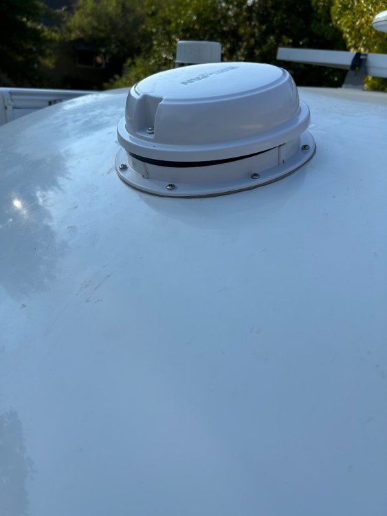

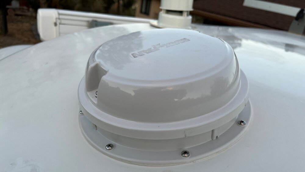

This is before the rain shield.
After rain shield.
Sweet!  Very clean install, Mike!

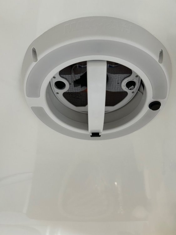

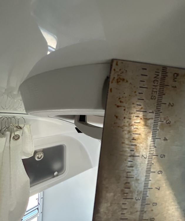

Couple of questions for y`all. Did anyone countersink the drill holes? Think I read somewhere using a countersink bit helps prevent gelcoat cracking. Also, how much lower does the light bezel hang than the original? I'm pretty close to the ceiling in there as it is. Thanks.
Yes, we used a countersink bit...  The bezel hangs about an 1" from the overhead:
Hope this helps out...
