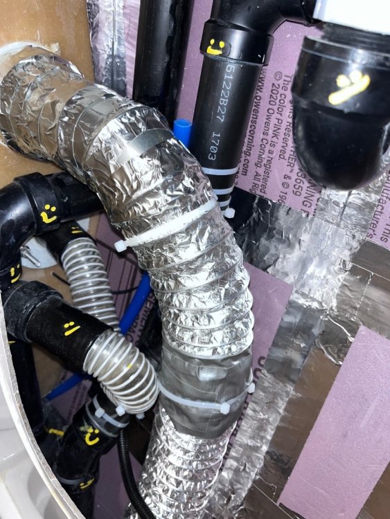

WS, that is disheartening. I suspect that my hose is glued at the end under the toilet paper holder, as it should be. It has no clamp on it.  As I said previously, remove the fan housing, 2 long machine screws. Easy. Here is my sink area (Hull 218) after some mods, you can see the factory vent hose. My trailer has happy faces all throughout the waste system, on every glued joint, from an inspector. It is rather cute.
